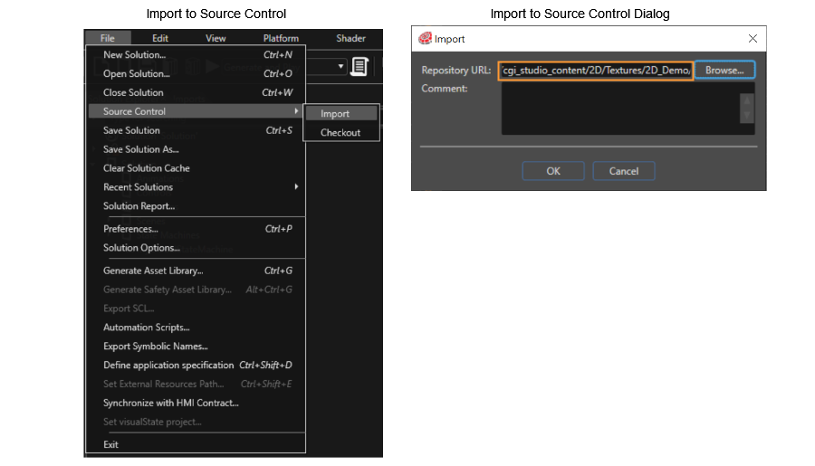

Import to Source Control
If an entity is not in repository, it can be added by choosing the menu option "File" > "Source Control" > "Import".
You will be prompted for the repository URL and an optional comment in order to add the solution to the specified repository.
You have to enter at least part of the Repository URL into the input field manually. The "Browse..." button opens a repository browser window, which helps you to find your desired location in the repository.

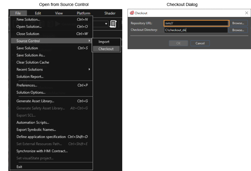

Checkout solution from source control
A solution that has already been saved in a repository, can be opened from the Source Control by selecting the "Checkout" menu option from "File" > "Source Control".
In the checkout dialog you can fill in the information about the Repository URL and choose the location.

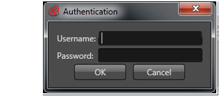

The first time you will be asked to authenticate. Following dialog will appear and the username and password for the repository will be requested.

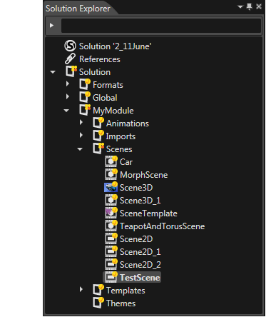

The content of the solution loaded from source control is displayed as any other solution in the Solution Explorer. All the items will have specific icons indicating their source control status.

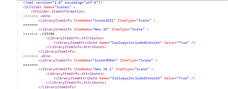

Whenever a conflict is reported, you should open the file in question, and search for lines starting with the string <<<<<<<. The conflicting area is marked like this:

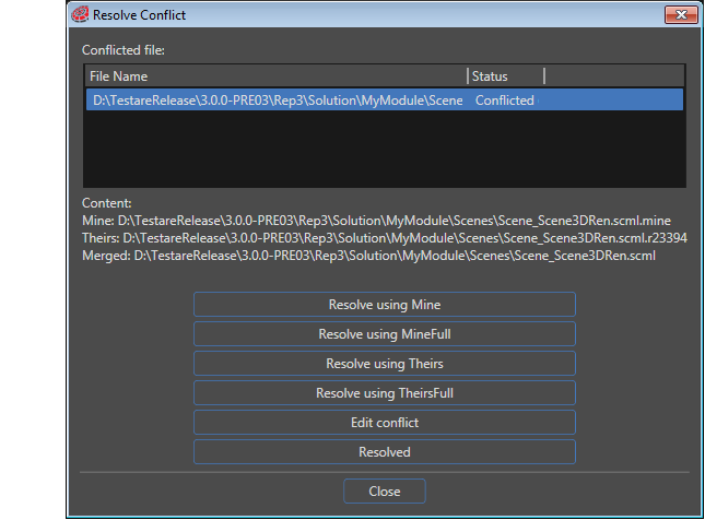

In order to resolve a conflict, the user has more than one option to choose from.
The following alternatives are offered in the "Resolve conflict" dialog that opens from the contextual menu "Source control" > "Resolve conflict" option:
  1. Resolve using Mine : resolve the current conflict by choosing the local version (FileName.extention.mine) on all conflicts, for the rest it uses the auto-merged. The conflict is "Marked as resolved" by default after choosing this option.
  2. Resolve using MineFull : resolve the current conflict by choosing the entire local file (FileName.extention.mine). The conflict is "Marked as resolved" by default after choosing this option.
  3. Resolve using Theirs : resolve the current conflict by choosing "their" file which is the incoming file (FileName.extention.rNewVersionNumber) on all conflicts, for the rest it uses the auto-merged. The conflict is "Marked as resolved" by default after choosing this option.
  4. Resolve using TheirsFull : resolve the current conflict by choosing the incoming file(FileName.extention.rNewVersionNumber). The conflict is "Marked as resolved" by default after choosing this option.
  5. Edit conflict : opens an editor where the user can edit the new revision file(FileName.extention.rNewVersionNumber), the file .mine (FileName.extention.mine) and upon these changes the merged file will be changed dynamically. After this, the user will save the changes and will be able to mark the conflict as resolved by pressing the "Mark as resolved" button. Please note that the "Mark as resolved" command does not really resolve the conflict. It just removes the FileName.extention.mine and FileName.extension.r* files, to allow the user to commit the changes.
  6. Resolved : the user decides only to mark the conflict as resolved leaving the file as it resulted after the latest update, without making other changes on file. This way the user will be able to commit the file.

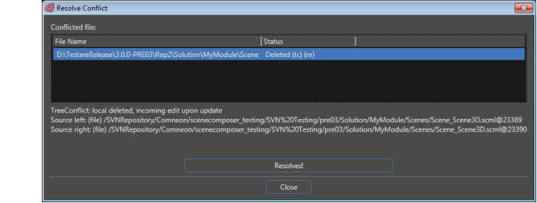

Tree Conflicts
As it was previously mentioned, a tree conflict occurs when a user has renamed/deleted/moved a file/folder which another user has either renamed/deleted or moved in the meantime.
There are many different situations that can result in a tree conflict, and all of them require different steps to resolve the conflict. For the moment, SceneComposer subversion feature only offers the option "Resolve" for tree conflicts.
The Resolve command does not really resolve the conflict. It just removes the FileName.extention.mine and FileName.extention.r* files, to allow the user to commit his changes. The user will manually resolve the tree conflict or use an external tool.
From the Solution explorer panel, select an item and choose "Source Control" > "Resolved conflict" context menu option.
In the new opened dialog the user will be able to see all existing conflicts and their types (file conflict or tree conflict).
After the user marks the conflict as resolved he can decide whether he will cancel or commit his local changes.
