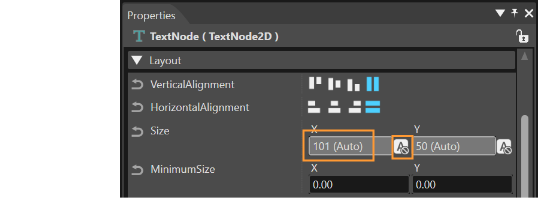

The text "(Auto)" inside of a read-only properties field indicates that this property has an Auto-Value. The user can interact with auto-values through the switch button which is available in the Properties panel on the right side of the Auto-Value field. In the image below, you can see that the vertical and horizontal size value is an Auto-Value, each having a corresponding switch button on their right.
As can be seen in the image above, a suffix indicates that the value is "auto". As expected, if the button is used the value will become editable and the user will be allowed to modify it as desired.
