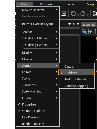

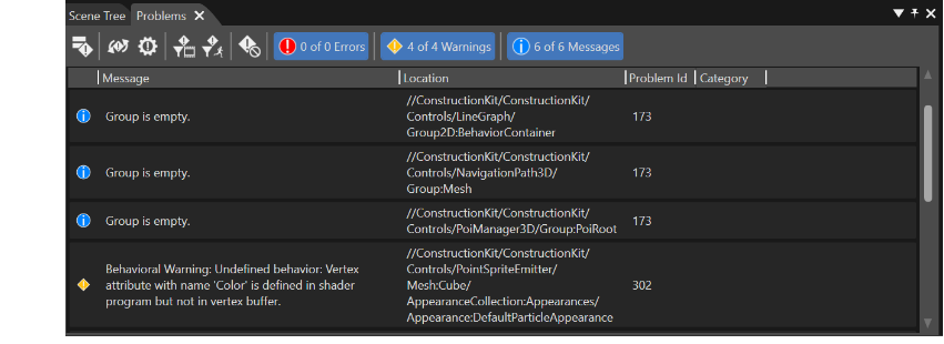

A dedicated problems browser is available, which can be activated through "View" > "Output" > "Problems"
A problem is a message related to one item in the solution.
In addition to the message itself the problem also has a numeric Id, a severity category (Info, Warning or Error) and a source service (Scml Parser, Shader compiler, etc). By right clicking on the header, it is possible to hide any of its sections or, by using the drag and drop option it is possible to change their order.
The problems browser lists three different categories of problems:
  • SCML Errors
  • Shader Compiler Errors and Messages
  • Missing Dependencies
It is possible to explicitly select information related to one of these categories in the "Category" checkbox. With the buttons placed in the top of the Problems browser, the displayed problems can be filtered according to their origins:
  • "Show Only the Suppressed Problems": Display just those problems which were suppressed by the user.
  • "Filter Problems by Selected Scene": Display problems only related to the selected scene.
  • "Filter Problems by Selected Animation": Display problems only related to the selected animation.

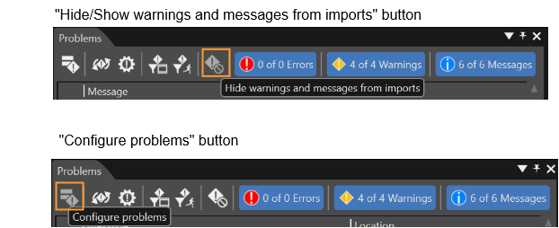

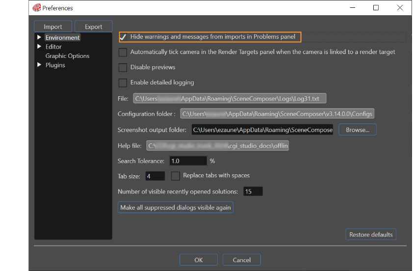

To get focused on problems related to SceneComposer solution configuration, it is possible to suppress warnings or messages solely related to imported content. The first option is ticking the checkbox "Hide warnings and messages from imports in Problems panel" in the "Environment" section of the "Preferences".
The same persistent setting can be toggled directly in the Problems panel by using the button "Hide/Show warnings and messages from imports":

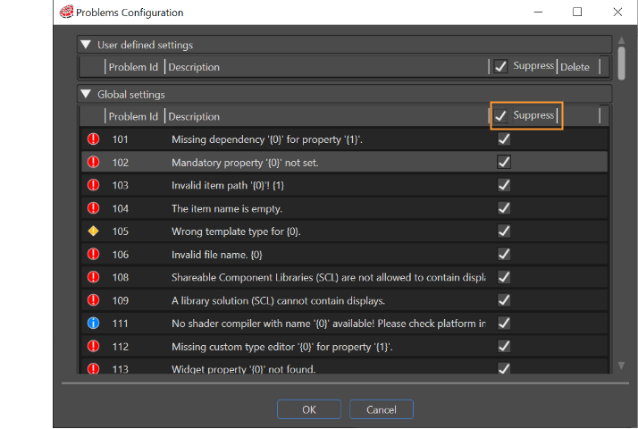

The forth way to hide warnings is from the problems configuration dialogue - by ticking the "Suppress" checkbox - which is available from the problem browser via "Configure problems" button.
The option to hide warnings is available just for "Warnings" and "Info", not for "Errors".
This setting can also be made in Solution Options > Problems Configuration.

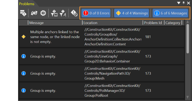

The buttons on the right side of the "Problems" panel can be used to select the type of information to be displayed:
  • Errors
  • Warnings
  • Messages
It is possible to combine the results of these three types of filtering to obtain the desired output.

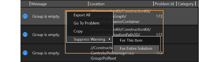

When right clicking on any selected problem, a context menu gets opened. The context menu shows three different options.
  • Export All : a .csv file with al the problems will be exported in a place specified by the user.
  • Resolve : Offers an additional context menu to resolve the problem.
  • Go to Problem : the user will be able to reach immediately the place where is located the problem which has to be solved.
  • Copy : the message of the problem will be copied on the clipboard.
  • Suppress Warning : You can choose if the problem should be suppressed for this item or for the entire solution.

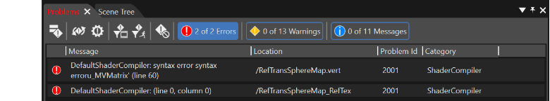

When faulty shader program modifications are being committed in the Shader Editor, shader compiler errors are displayed in the Problems view:
After successful shader compilation, a regarding message is displayed:
