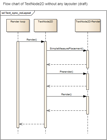

First case: No layout usage
Candera::TextNode2D has no real layout information. There is also no layout in which the Candera::TextNode2D is integrated. Therefore, trigger the render process for text render process is enough. The text is not bound to an area and has no relationship other than the visible layer to any other node in the scene graph.

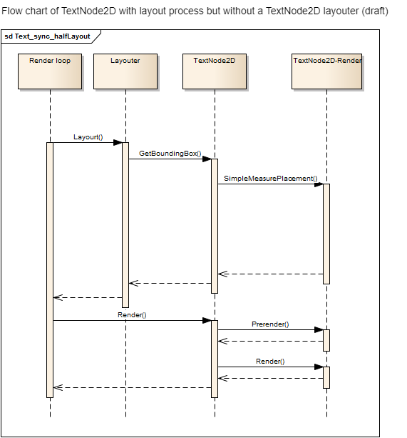

Second case: Layout process but no TextNode2D layouter
Candera::TextNode2D has no real layout information. However, it is arranged within a layout (e.g. GridLayout). This implies that Candera::TextNode2D has to provide actual layout results to arrange the text within the layout area. Therefore, the layout process has to start the text render process beforehand. The text render process has to complete the first step (measurement and placement) when the layout process evaluates the bounding box of the text. The layout process has no influence on the size of the bounding box. It only receives the information of the bounding box and can place all the other nodes around the text. The actual handling of this information is defined by the used layouter.

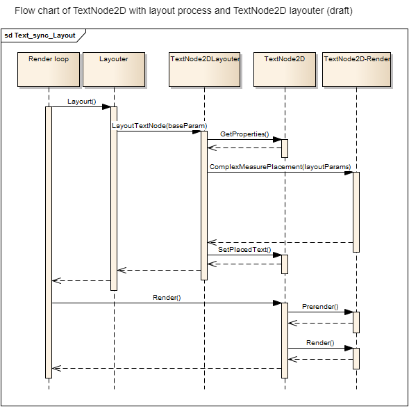

Third case: Layout process with TextNode2D layouter
Candera::TextNode2D provides layout information. Additionally, the general layout process can influence the way text is displayed, too. The layout process can propose a maximum area in which the text has to fit. This has a direct impact on the placement. The text itself provides the layout process a bounding box which were actually used by it.

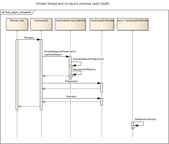

The default way of asynchronous text rendering is the usage of a worker thread. The render loop delegates the first step, Measurement and Placement, to a worker thread. Every delegate is placed in a queue and ready for processing. Using a worker thread has its main advantage in not blocking the render loop. The render loop itself will not block until the text has been measured and placed. The disadvantage of this approach is that there is no control over the execution moment and result arrival time. It can happen after a single render cycle but also after an undefined amount of cycles.
The next figure shows in a draft how the measure and placement process has been replaced when asynchronous text rendering is used. For simplicity only the way without a layouter is used. All other ways do replace the measurement and placement process with the same approach in their flow chart.
The function which actually triggers the asynchronous process has to be triggered twice. One time to queue the process and a second time to retrieve the result. In this flow chart sample the Render-method has to be called twice. The second call has to be done when the asynchronous process has actually finished.

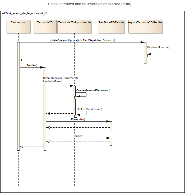

Asynchronous text rendering - Single threaded
Asynchronous does not mean the work load has to be done by another thread. It can also be done by the same thread at another point in time. The main disadvantage of the single threaded version is that the render loop thread is still handling the text. However, this time it does not have to handle every text in a single render cycle. The amount of texts which will be rendered in a cycle can be determined.
This implies that two factors are given: Text/cycle and text to handle. Based on this information the amount of cycles needed to calculate all texts can be estimated. The duration of each cycle cannot be determined, though.

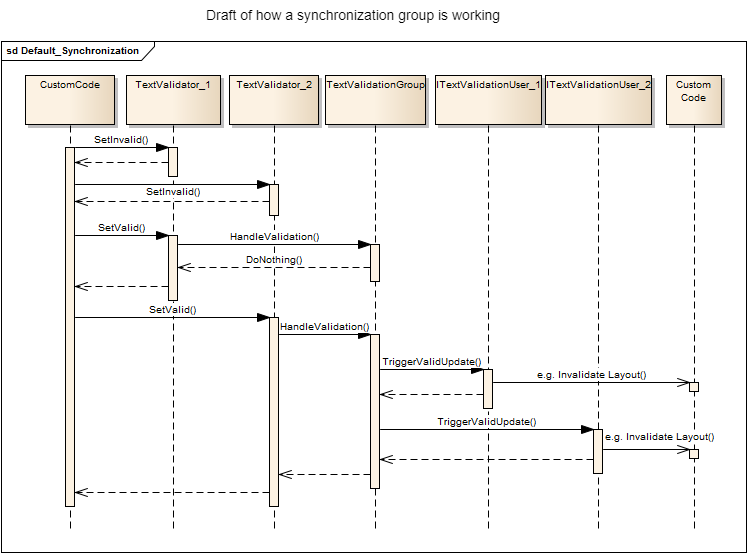

The default synchronization is kept as simple as possible. This section describes the lifecycle of the validation and how does the synchronization works including its flaws.

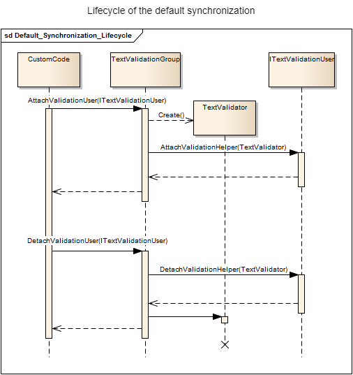

Lifecycle
Every object which has to be synchronized implements the interface Candera::TextRendering::ITextValidationUser, e.g. TextNode2D. In the next step this object has to be attached to a Candera::TextRendering::TextValidationGroup. The default group is a singleton instance. The Candera::TextRendering::TextValidationGroup creates a specific validator and attaches it to the object. Detaching the validator is comparable to this process.
Synchronization - flow
The object can be invalidated at any time by calling the invalidation method of the Candera::TextRendering::TextValidator. Every time an invalidated object changes it state to validate, the Candera::TextRendering::TextValidator notifies the group of its validation change. If all objects of the group are valid now, all update methods of these objects will be called.
In case of the Candera::TextNode2D with an attached layouter, the layout of the scene in which the Candera::TextNode2D lies will be invalidated. If there is layout process used at all (disabled Candera layout functionality) nothing will be done in the update method. However, the render method itself can handle this case when it is newly called. The issue here is that it is not explicitly specified who will trigger the render. Both render and layout mechanisms of will check whether the whole group is valid or not. Only in case that the whole group is valid, the text will be updated. If the layout is triggered by another object despite the fact that the group is not valid, the text will not be updated.
Candera::TextNode2D attaches itself to the Candera::TextRendering::TextValidationGroup singleton instance per default. To exclude it from the synchronization group it has to be explicitly detached first.

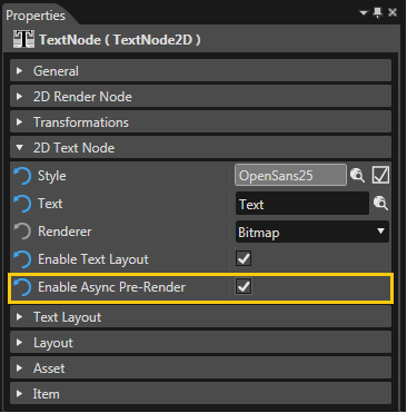

Asynchronous TextNode2D and CanvasText
Enabling the asynchronous text rendering is something that has to be done on each Candera::TextNode2D or Candera::CanvasText. This can be done within the SceneComposer:
Or in code itself:
void SetAsyncPreRenderEnabled(bool enabled); bool IsAsyncPreRenderEnabled() const;
Example usage:
TextNode2D node; node.SetAsyncPreRenderEnabled(true); //Enables async rendering node.IsAsyncPreRenderEnabled(); //returns true node.SetAsyncPreRenderEnabled(false); //Disables async rendering node.IsAsyncPreRenderEnabled(); //returns false
The flag in SceneComposer and code can be equally configured in Candera::CanvasText.
