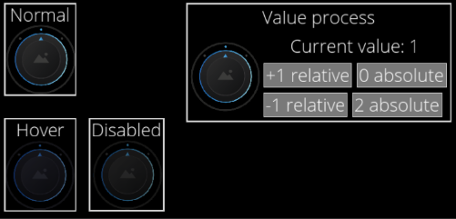

CoreDial
This control is used to set values within a specified range. Rotating the knob changes the value and updates the corresponding display. The degree of rotation is adjusted according to the configured Step Size and snaps to predefined positions. The knob's state is represented by displaying an image from the BackgroundImages list corresponding to the current value. For example, in a three-step rotation setup where the minimum rotation is -45 degrees, the maximum rotation is +45 degrees, and the step size is 45 degrees, three BackgroundImages need to be assigned. Additionally, values can be adjusted using specified keyboard keys (Increment Key Code, Decrement Key Code).
In the Core version, focus and color blending functionalities are not included, and the design is specialized for basic rotational operations.
Properties
Property Name
Type
Enabled bool If set to false it will not react on focus events and does not have to support different visualizations for the different states.
Focusable
bool
If true, the control is focusable. Otherwise the control can not be focused.
Current Value
FeatStd::Int32 Current value for the dial.
Step Size
FeatStd::Float Step size in degrees.
Minimum Rotation
FeatStd::Float Minimum rotation of the dial.
Maximum Rotation
FeatStd::Float Maximum rotation of the dial.
Knob Image
Candera::Image2D The image to set on the effect.
BackgroundImages
Candera::Image2D A list of images which should be available for selection.
Disabled Color
Candera::Color The color which can be used from other Behaviors.
Increment Key Code
Candera::KeyboardKeyCode::Enum Check the KeyCode of the pressed key (can also be modifier).
Decrement Key Code

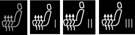

CoreMultiStateButton
A UI element that allows for the easy definition of buttons with multiple states. Each click changes the state, and once the maximum value is reached, it loops back to the initial state. The corresponding image is selected based on the button's state, and the displayed text can also be modified using the Text property. The behavior of the MultiStateButton can be set in the EventHandler, and actions corresponding to the current state can be executed using the Process Value Changed Event behavior.
Properties
Property Name
Type
Focusable
bool
Current State
Variant
Current state of the MultiStateButton (starts with 0).
Maximum State
bool/Variant
Maximum value of MultiStateButton (starts with 0).
