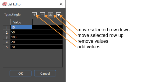

List Editor
The Values List property can also be set using the List Editor. Click on the "Select Item" icon at the right side of the Properties panel to open the List Editor and set the value of the bar in Value column. The total number of rows in List Editor represents the total number of bars. The bars are aligned from left to right, starting with the smallest row number.

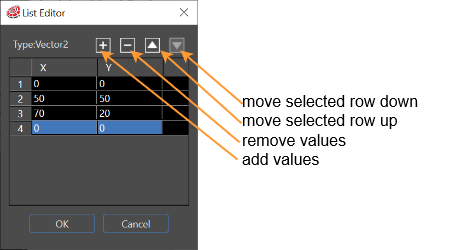

List Editor
The Values property can also be set using the List Editor. Click on the "Select Item" icon at the right side of the Properties panel to open List Editor, and set the values for the X and Y axes. The number of rows in List Editor represents the number of plot points in the line chart.
