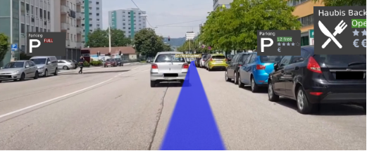

2. Use Case: Navigation Overlay
Major elements for this use case are:
- Video Streaming: Rendering from a video source into a texture.
- Camera Tracking: Updating the moving AR camera via data binding.
- Navigation Path: Visualization of the proposed path a navigation system.
- Points of Interests (POIs): Loading POIs (e.g. street names, buildings, ...) from an external dictionary and place them in the scene at runtime. Metadata is received as JSON formated string.

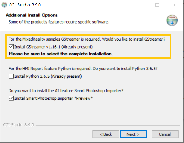

Please also note that, the Android Evaluation Package comes with an installer and by default, the CGI Player is built with streaming enabled. The recommendation is to check the "Install GStreamer" option in the provided installer, and do a "Repair" installation regardless of whether GStreamer is installed or not, because of some dependencies.
If in any case the CGI Player still looks for a missing dll, check that the GStreamer is set in the PATH environment variable, or copy the GStreamer dlls to the same location as the CGI Player executable.

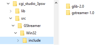

Copy the following folders from your GStreamer installation directory (C:/gstreamer/1.0/msvc_x86/include) to folder cgi_studio_3psw/src/GStreamer/Win32/include

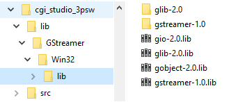

Copy the following folders from your GStreamer installation folder (
Copy the following library files from your GStreamer installation folder (

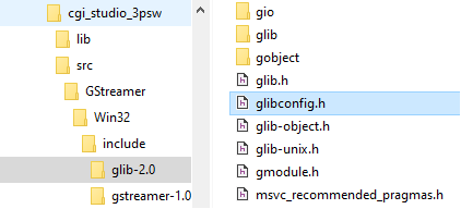

Copy the following file from your GStreamer installation folder (C:/gstreamer/1.0/msvc_x86/lib/glib-2.0/include/glibconfig.h) into folder cgi_studio_3psw/src/GStreamer/Win32/include/glib-2.0
