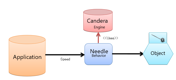

The purpose of Behaviors is to perform modifications to the content presented to the user.
While it would be possible for the application to directly perform any required change directly to the nodes of the scene tree this would require quite complex application code. The application would need to be specifically tailored to a single solution and every change to the scene tree might require a change in the application code. To avoid this strong dependency, Behaviors are used to perform the actual modification on the content.
The following impact has to be considered: Cross-references (nodes or behaviors) to different scenes may occur. For details see Cross-Reference Implications below.
Their advantage is that they after they are created they can be easily used in Scene-Composer by people without any coding knowledge. By adding configurable properties they can be adapted to apply in multiple different scenarios without the need to create new ones. Further the application code can be simplified as it only needs to provide an "input" for the Behaviors. It is no longer responsible to decide how the content needs to be modified based on the input.

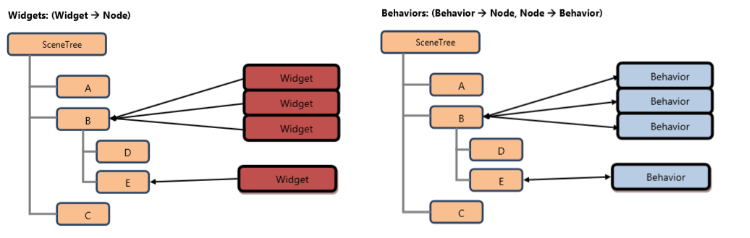

OWNERSHIP
While (most) widgets are attached to a node they are considered part of the scene itself. A widget does know about the node it is attached to but the node does not know about the widget.
This can cause problems if multiple widgets should collaborate as by default they can not know which other widgets they should interact with. To overcome this problem it was required to either specify "other" widgets a property (type is Candera::WidgetBase*) directly in the widget or store custom information on the node about other widgets that are also attached.
Behaviors have simplified this by now longer considering them as part of the Scene but rather part of the node. Each node has a Behavior-Container which hold all attached behaviors for this node. Via this container it is now easily possible to communicate and collaborate between different behaviors.
