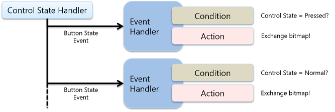

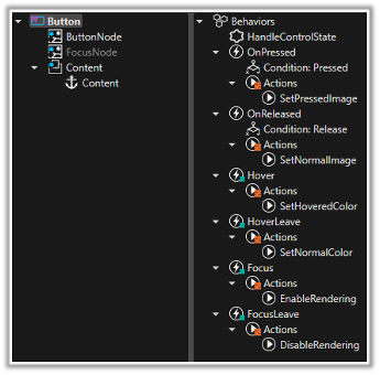

The Control State Handler Behavior sends its state as an event. Event Handler Behavior uses a „Check Control State“ condition. If the Condition is positive, one or more Actions are invoked.

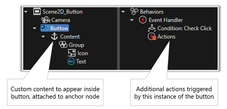

The internal Behaviors define how the appearance of the Button changes. The user can add additional actions to a Button instance like starting an animation or triggering transitions.

- Custom content is not limited to a simple text, anything can be attached to the anchor node.

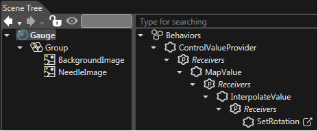

Compared to the Button Control the Gauge Control rather visualizes a value instead of states. This value is passed along a processing chain. Further wise the value is used for actions
- Transformation (rotation, psoition, size, ...)
- Graphicsl effect (alpha, switch image, zoom, ...)
- Manipulating an animatoin, invoking an action, ...

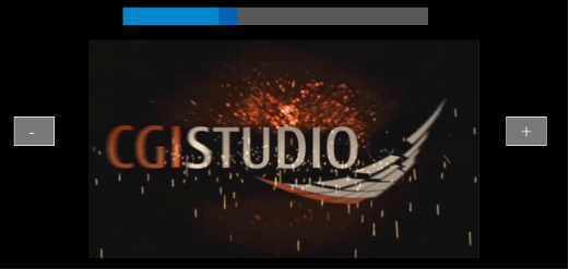

Place the Controls accordingly. Note that one button increases the FlipBook-value while the other lowers it. In the end the scene should look similar to this example:

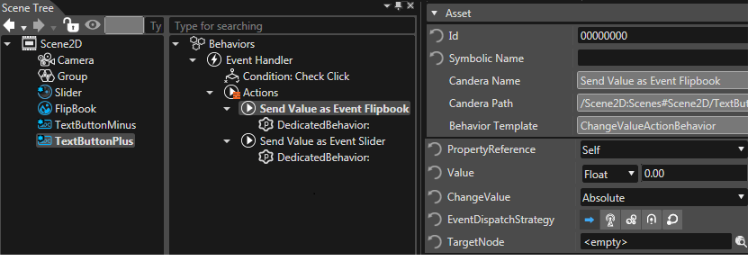

Connecting the Buttons with the FlipBook works a bit differently because the value of the FlipBook should be increased or decreased relative to the value. To connect a Button with the FlipBook add a "Send Value as Event"-Behavior to the "Actions"-section of the Behaviors of the Button. This Behavior can be found under "Action/Property/". Assuming that this is the button that increases the value the Value-property must be set to "1.00". Because the value should change relatively to the current value the "ChangeValue"-property must be set to "Relative". Finally, the target node should be set to the FlipBook.
Note that for a better interaction the Slider should also jump to a new position if the Button is pressed. Therefore the same procedure has to be done as in the last paragraph, just for the Slider. This means that a new "Send Value as Event"-Behavior should be added to the Button whereas its target node is the Slider this time.
In the end the Button that increases the value of the FlipBook should look similar to the following screenshot:

The final result of this control-composition can be best seen in the Player. The slider can be slided via touch-input whereby the FlipBook animates according to the position of the Slider-knob. Further wise the buttons can be pressed to switch to the next or previous image. This also sets the slider to a new position.
