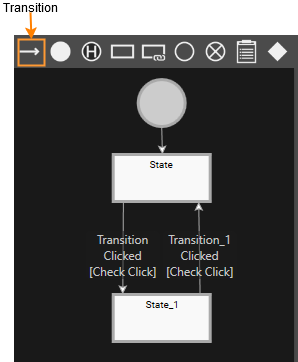

  2. In State Machine Editor add another state by dragging a State from the upper right toolbar and dropping it into the State Machine diagram below the already existing state.
    • A new state "State_1" will be created in the State Machine Editor.
  3. In State Machine Editor add a transition from "State" to "State_1" and another transition from "State_1" to "State". To do this drag a Transition from the toolbar onto the outgoing state (e.g. State) then click onto the second state (e.g. State_1).
    • 2 Transitions will be added from State to State_1 and back

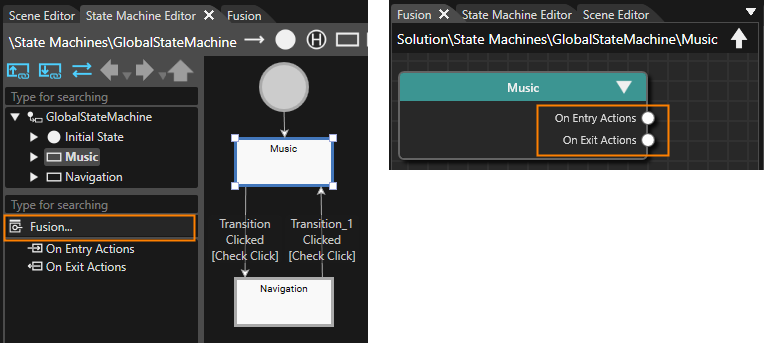

Here we are using Fusion to define the actions to be performed when entering and exiting the Music and Navigation State. In the Fusion diagram of TextButton_Music and TextButton_Navigation we connect a HandleControlState behavior.
  1. While the state "Music" is selected in the State Machine Editor click on the [Fusion...] button on the bottom left.
    • Fusion will be opened, displaying the Fusion node "Music".
    • The displayed Fusion node offers 2 behavior connectors: one for [On Entry Actions] and one for [On Exit Actions].

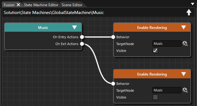

  2. In the [Music] Fusion Node drag the [On Entry Actions] connector circle to the right and release the mouse.
    • A Select Behavior dialog will be opened.
    • This dialog has an input field on top and a list of behaviors organized as a tree on the bottom.
    • This list of behaviors is similar to the one in the Toolbox panel's [Behaviors] section.
  3. In the Select Behavior dialogue find the "Enable Rendering" behavior and double-click it.
    • In Fusion a new [Enable Rendering] node is created, which is connected to the Music's [On Entry Actions] connector.
      Use the dialogue's input field and start typing "Enable Rendering". While you are typing, the list of behaviors decreases as the content of the input field serves as a filter.
  4. In Fusion configure the [Enable Rendering] node according to the table below.
    • The [Enable Rendering] node is fully configured.
    • Whenever GlobalStateMachine enters the state "Music", the GroupNode "Music" will get visible.
      Music Node
      On Entry Actions > EnableRendering
      TargetNode
      IVI_Sample > IVI_Sample > Music
      Visible
      TRUE
  5. Repeat similar steps to create an [EnableRendering] Fusion Node for the [Music] node's [On Exit Action] connector. Configure this new [EnableRendering] node according to the table below.
    • Whenever GlobalStateMachine exits the state "Music", the GroupNode "Music" will get invisible.
      Music Node
      On Exit Actions > EnableRendering
      TargetNode
      Visible
      FALSE

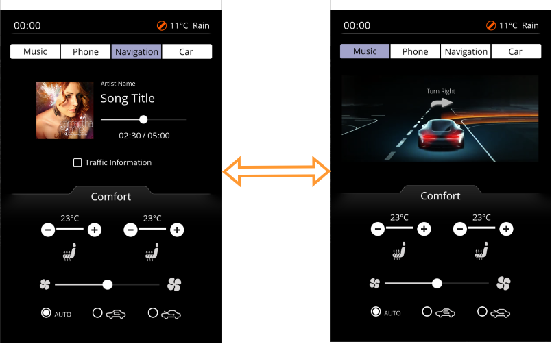

Check the Transitions in Player
Use the Player to check the configured transitions between Music and Navigation.
  1. Save your solution and click the [Play selected scenario...] icon on the toolbar to start the Player.
    • Three windows will open, and you can see that the simulation display shows the IVI_Sample scene.
    • The Music GroupNode will be displayed.
  2. In the simulation display click the Navigation menu button.
    • The Navigation GroupNode will be displayed.
  3. In the simulation display click the Music menu button.
    • The Music GroupNode will be displayed again.
