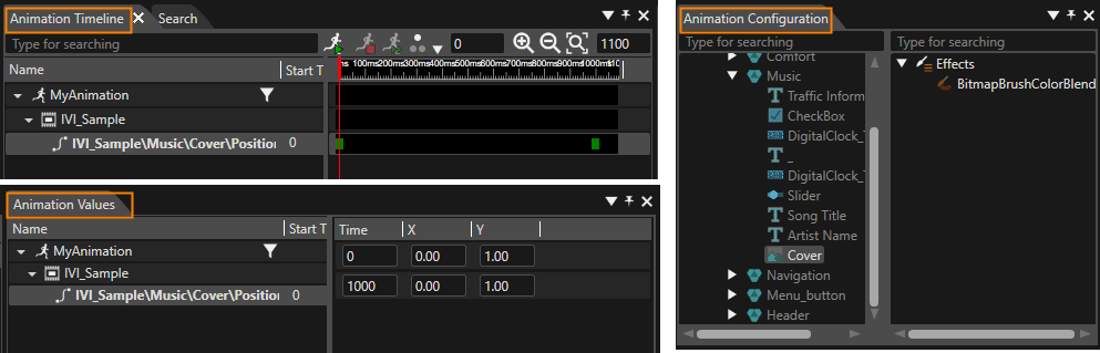

- Scene Composer switches to Animation Design. Three new panels are visible:
- Animation Configuration panel
- Animation Timeline panel
- Animation Values panel

- In the Animation Configuration panel's scene tree select the same Cover node as before. In the Properties panel click on the [+] button.
- The Property Animation Configuration will be opened.
- In the Property Animation Configuration apply the settings as in the table below and press [OK].
- A new keyframe sequence for the property "scale" has been added to the existing animation MyAnimation.
- This can be seen in the Animation Timeline, in the Animation Values panel and in the Properties panel.
Selected Animation MyAnimation Property Scale Interpolation Spline Create new keyframe sequence X and Y
- In the Animation Values panel select the animated properties and enter the configurations from the table below.
- The keyframes for the animated properties are fully configured.
IVI_Sample\Music\Cover\Position\XY Time X Y 0 138.00 140.00 1000 104.00 207.00 IVI_Sample\Music\Cover\Scale\XY Time X Y 0 0.50 0.50 1000 1.00 1.00

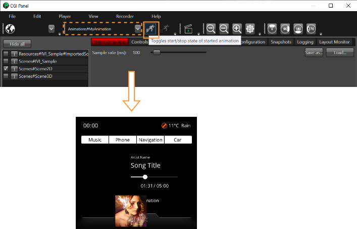

Check Animation in Player
Use the Player to check the configured animation.
- Save your solution and click the [Play selected scenario...] icon on the toolbar to start the Player.
- Three windows will open, and you can see that the simulation display shows the IVI_Sample scene.
- In CGI Panel below the menu select your animation from the drop-down list and press the "run animation" button right next to the drop-down list.
- The configured animation of the Cover image will be started and played once in the simulation display.
