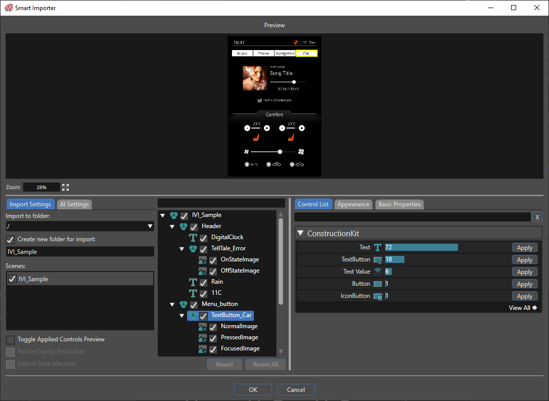

Recommended PSD Layers Structure for Smart Importer
When creating PSD files using Adobe Photoshop, it is recommended that the naming and structure of the Photoshop layer controls be pre-matched to SceneComposer. This will allow for smooth application of controls and their properties when importing with SmartImporter. The list below shows the Controls that will be assigned in Scene Composer via Smart Importer. Press the links on each Control to jump to the page showing the recommended layer structure in detail.
It is important to note that the Smart Importer cannot process effects, masks, filters in Photoshop. Therefore, if you want to use these features, please rasterize the images in advance.
 Some Controls are included in the sample file "IVI_Sample.psd" and are explained with specific examples.

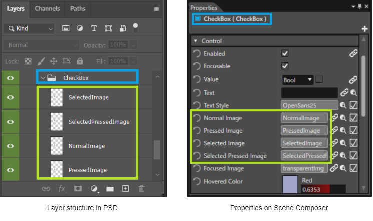

CheckBox
The CheckBox Control can easily be configured with a text, images for a normal and a pressed state as well as for a selected and a selected pressed state.
Group name
CheckBox
Layer
SelectedImage
SelectedPressedImage
NormalImage
PressedImage

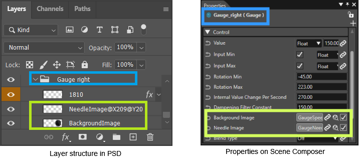

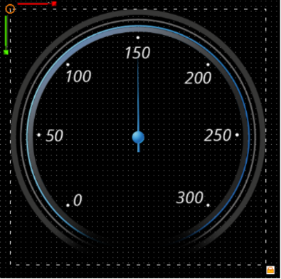

Gauge
The Gauge allows to rotate a needle on a background according to its input value.
Group name
Gauge
Layer
NeedleImage
BackgroundImage

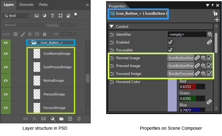

IconButton
IconButton has similar functionality as the standard button, but in addition an icon (image) is placed on top of the button.
Group name
IconButton
Layer
NormalImage
PressedImage
FocusedImage
IconNormalImage
IconPressedImage

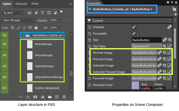

RadioButton
The RadioButton Control can easily be configured with a text, images for a normal and a pressed state as well as for a selected and a selected pressed state.
Group name
RadioButton
Layer
NormalImage
PressedImage
SelectedImage
FocusedImage
RadioButton (In the image, it is RadioButton_Outside_air to distinguish it.)

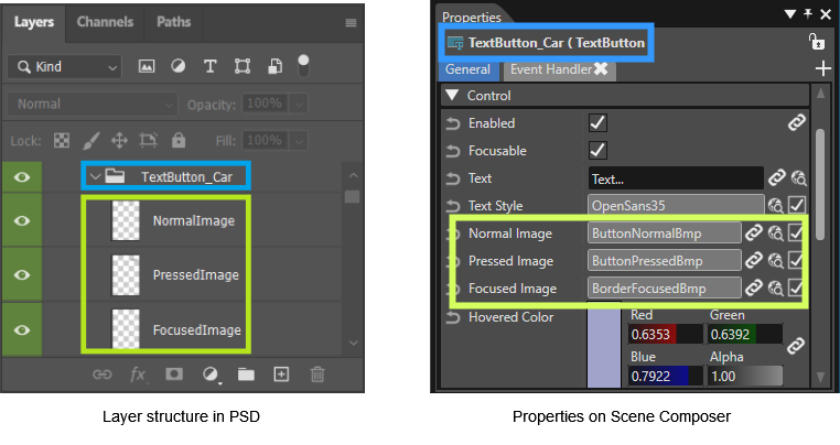

TextButton
The TextButton Control offers an easy way to define all different states of a button and an action that is performed when clicking it.
Group name
TextButton
Layer
NormalImage
PressdImage
FocusedImage

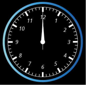

AnalogClock
An analog clock with images for the certain needles (hours, minutes, seconds).
Group name
AnalogClock
Layer
SecondsNeedleImage
MinutesNeedleImage
HoursNeedleImage
FaceImage

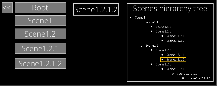

Breadcrumb
A Breadcrumb shows the history/flow through the screen hierarchy and allows user, for example, to navigate between scenes using breadcrumb's elements.
Group name
Breadcrumb
Layer
Name
EllipsisText

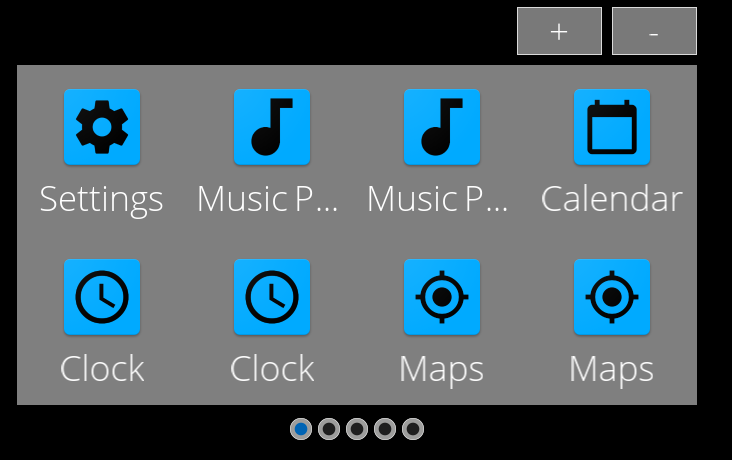

Menu Screen
The Control represents a menu in the form of a grid of icons (instances of the Menu Item Control).
Group name
MenuScreen
Layer
BackgroundImage
FocusBorderImage

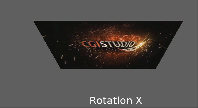

Mesh2D
Performs a perspective projection of a 3D rotated effect based on the configured origin, rotation and field of view.
Group name
Mesh2D
Layer

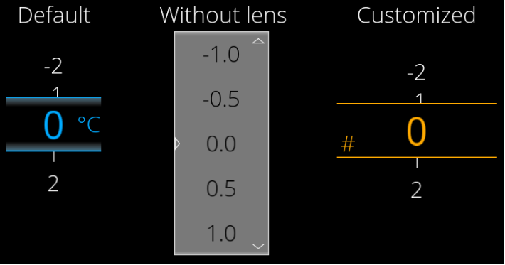

Roll
The Control represents a vertical list of numeric values from a specified range with a specified step.
Group name
Roll
Layer
DecorationImage
TextEditBackground

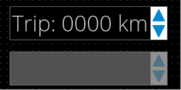

SpinBox
A spin box or spin button is a control that enables users to increase or decrease the number value by a specific increment via clicking an up or down arrow button.
Group name
SpinBox
Layer
BackgroundImage
ArrowUpNormalImage
ArrowUpPressedImage
ArrowDownNormalImage
ArrowDownPressedImage
