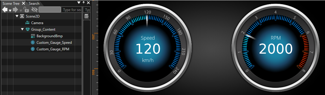

  9. Select the Custom_Gauge controls one after the other. In the Properties panel configure the properties as given in the tables below.
    • In the Scene Editor the gauge controls for RPM and Speed are both visible.
    • The Scene2D starts to look like a cluster, see image below.

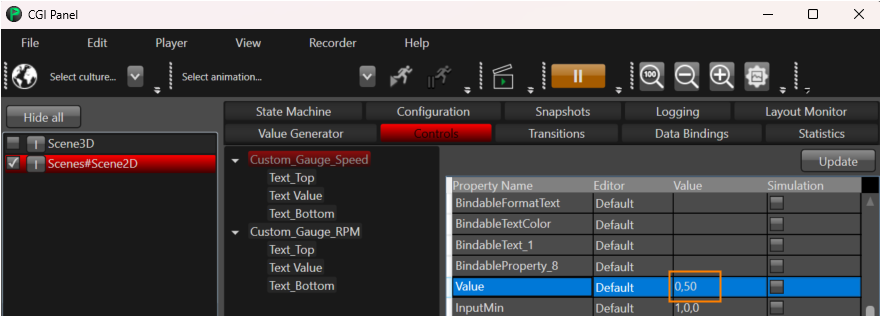

Check the Scene in the Player
  1. Save your work and start the Player to test the functionality of your configuration. To do this, please perform similar steps to the ones described in the GettingStartedControls Best Practice.
    • The Speed Gauge can be tested by manipulating Custom_Gauge_Speed's Value Property (The property is changed to 50 in the image below).
    • The RPM Gauge can be tested by manipulating Custom_Gauge_RPM's Value Property.
