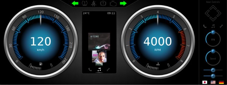

This solution shows an advanced 2D cluster example. It consists of various scenes that are necessary to represent an advanced Cluster. The Main Scene consists of gauges that can be manipulated with Controls and Behaviors. Other scenes, like ControlPanel scene, show various interactions within the solution and how this can be achieved with Behaviors. The ControlPanel scene also demonstrates how to switch between display languages.
This sample solution serves as an example of how Scene Composer can be used to easily implement an advanced 2D gauge cluster without requiring any coding.

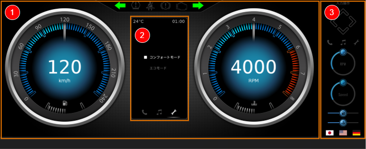

The Advanced Cluster solution consists of five scenes, using Scene Composer's versatile built in Controls to display an advanced 2D gauge cluster.
| No. | Category | Scene name | Description |
| (1) | Main | Scene2D_Main |
The main scene of this sample solution. Two gauges are displayed on the left and right side, various indicators are displayed in the top area. In the center some space is reserved to display one of the infotainment scenes Music, Phone or Settings.
| (2) | Infotainment |
Scene2D_Music Scene2D_Phone Scene2D_Settings |
This area displays the active infotainment scene (Music/Phone/Settings). Only the selected scene is displayed in the center of Scene2D_Main.
The following controls are mainly used:
| (3) | UI operation | Scene2D_ControlPanel |
A UI for operating the main scene and infotainment scene is displayed. Using this UI, you can change the speedometer/tachometer values, switch infotainment scenes, change the display language, and more.

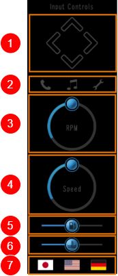

This solution offers the possibility to change the screen display via UI operation as described in the table below. This kind of interaction is achieved without any coding, but solely by configuring behaviors and a state machine.
(1) |
The left and right arrows switch infotainment (Music/Phone/Settings). The up and down arrows change the content of each infotainment. |
| (2) |
Click on the Phone/Music/Settings icon to switch the infotainment scenes. |
| (3) | The circular slider control changes the tachometer value. | |
| (4) |
The circular slider control changes the speedometer value. |
| (5) | The slider control changes the fuelmeter value. | |
| (6) | The slider control changes the water temperature meter value. | |
| (7) | Click the language icon to switch between languages displayed on the main screen and infotainment screen. |

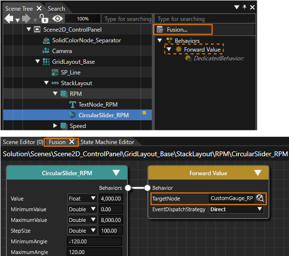

One of the ControlPanel's CircularSlider controls (CircularSlider_RPM) is used to remotely control the Main scene's tachometer value. The connection between CircularSlider_RPM and the tachometer (Scene2D_Main's CustomGauge_RPM) is a Forward Value behavior with CustomGauge_RPM as TargetNode.
When selecting the CircularSlider_RPM in the Scene Tree panel, the Forward Value behavior can be seen in the Extra Scene Tree. Pressing on the Fusion... button right above the Extra Scene Tree panel, Fusion will be opened displaying the CircularSlider_RPM's Fusion diagram. This diagram contains a Fusion Node Forward Value with a TargetNode property that can be confirmed to be set to Scene2D_Main's CustomGauge_RPM.
