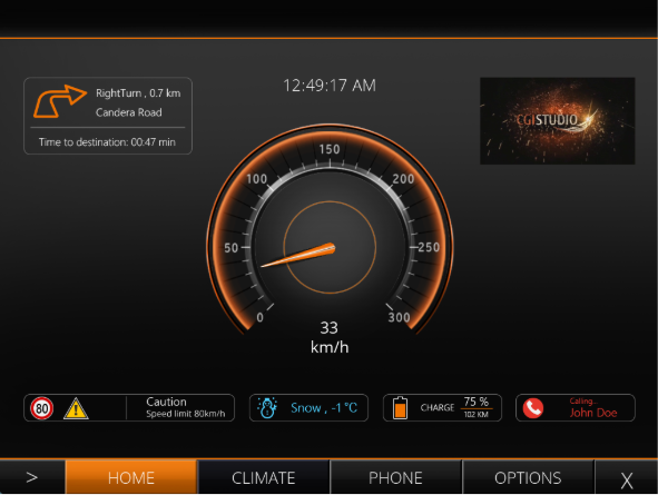

SceneHome
Scene for the main screen. The speedometer is displayed in the center of the screen, and navigation information, time, display, various indicators, etc. are displayed around it. In addition, the SceneMenuTabs scene is overlaid at the bottom of the display area.

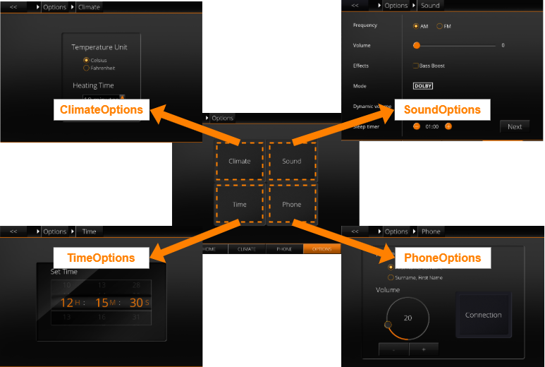

SceneOptions A scene for a screen to select one of 4 other options scenes.
ClimateOptions Scene for the climate-related settings screen to configure the temperature unit and heating time.
SoundOptions A scene for the audio-related settings screens with extensive possibilities.
TimeOptions A scene for the time-related settings screen.
PhoneOptions A scene for the phone-related settings screen.
ConnectionOptions A scene for the phone connection settings screen.

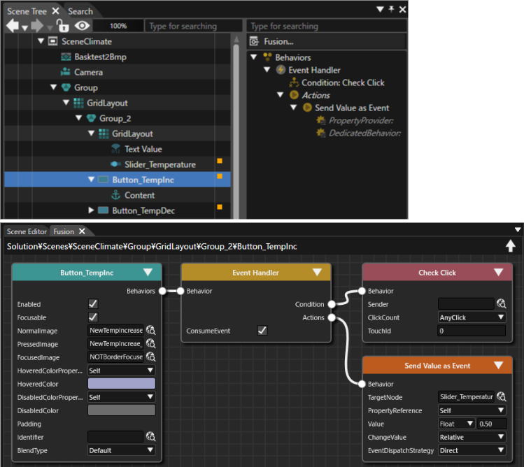

Behaviors are configured for each control to exchange data with other nodes as needed. Behavior settings can be viewed in the Extra Scene Tree or Fusion panel of the relevant node.

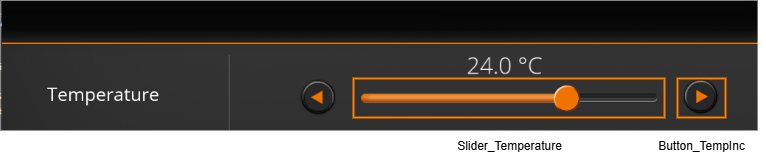

The image below shows an example of behavior settings for Button_TempInc (Button control) in the SceneClimate scene. The Button_TempInc is a button to increase the air conditioner's temperature setting in 0.5°C increments. Due to the behavior settings, each time Button_TempInc is pressed, a value of 0.5 is passed to Slider_Temperature (Slider control), synchronizing the button press action with the slider display.

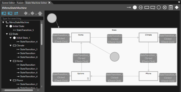

State Machine
The transitions between different scenes are configured using a State Machine (MenuStateMachine). Transitions of the Options scenes are encapsulated into a separate Subchart to keep everything neatly arranged.
The configuration of the State Machine transitions between scenes can be viewed in the State Machine Editor.

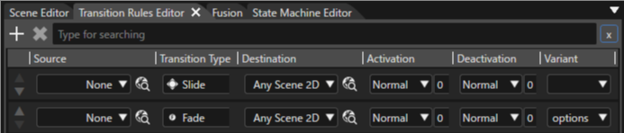

Transition
The Transition Type is set to Slide for transitions between SceneHome, SceneClimate, ScenePhone, and SceneOptions scenes. This causes a scene to slide from left to right to reveal the next scene. A Fade transition is set for transitions between option-related scenes. This is achieved using a Variant in the Transition Rule Editor.
Transition settings can be viewed in the Transition Rule Editor.

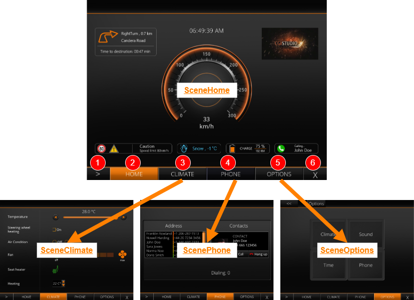

The initial screen of the GettingStartedControls solution is the SceneHome scene. If you move the cursor to the bottom of the screen, a tab menu will appear, and you can move to each scene from the tab menu. In each scene, you can check the operation of various controls used in the GettingStartedControl solution.
(1) Each time you click, the display screen will change in the following order: SceneHome -> SceneClimate -> ScenePhone -> SceneOptions (after SceneOptions, you will return to SceneHome).
(2) When clicked, SceneHome will be displayed.
(3) When clicked, SceneClimate will be displayed.
(4) When clicked, ScenePhone will be displayed.
(5) When clicked, SceneOptions will be displayed.
(6) When clicked, the SceneMenuTabs will be hidden.
From the SceneOptions scene, you can transition to scenes for various options.
