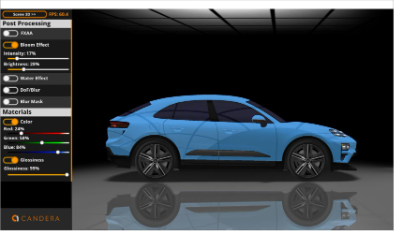

Example of post-processing a 3D scene Example of post-processing a 2D scene

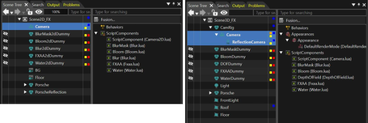

Key elements of this sample include the cameras in Scene3D_FX scene (both the main and reflection camera nodes) and in Scene2D_FX scene (Camera node). These cameras have post-processing scripts attached, taken from the ConstructionKit and SampleKit_PostProcessing as Script Components.

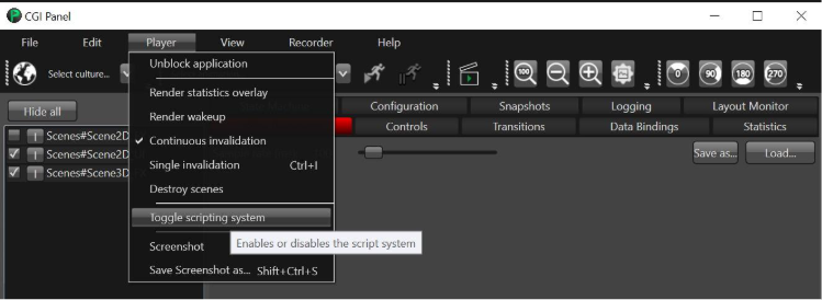

The scripting system for the Player can be enabled via the State Machine using the Enable Scripting System behavior or by Toggle Scripting System in the CGI Panel's menu bar.

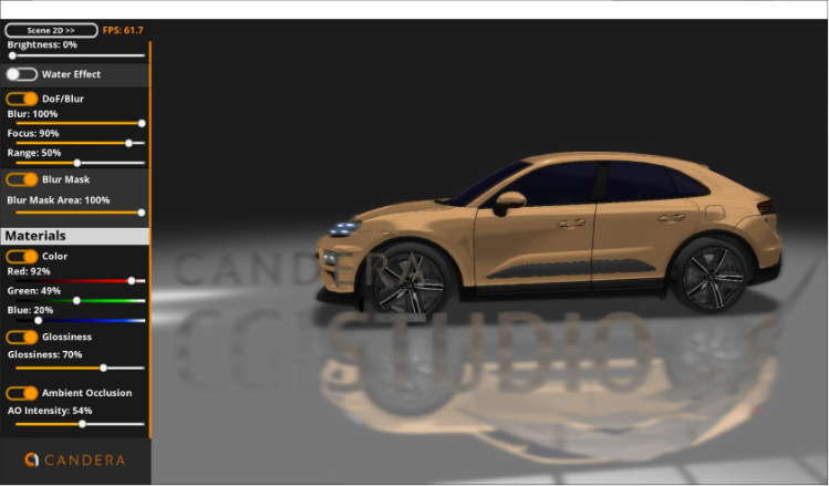

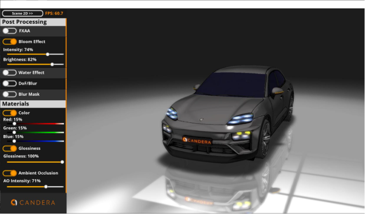

The Scene2D_UI handles switching between 2D and 3D views and provides toggle buttons for enabling/disabling individual post-processing effects. Each camera has a script (e.g., Camera.lua for 3D and Camera2D.lua for 2D) that stores its ID in a global table. Group nodes named after effects (e.g., BloomDummy, FXAADummy) have attached scripts (EnableCameraScript.lua, EnableCameraScript2D.lua) that control the activation of those effects. Post-processing scripts are toggled by enabling or disabling the rendering of these dummy nodes using the Enable Rendering Action behavior.
Several post-processing properties are animated and can be modified at runtime using sliders in the UI. Additionally, there's a Material Control section where users can adjust the PBR shader properties of the 3D model, such as Base Color (R, G, B), Glossiness, and the intensity of the baked Ambient Occlusion texture, using the same slider mechanism.

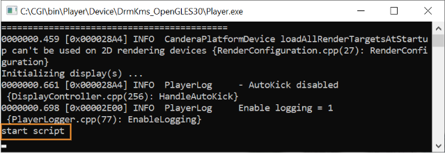

The script system of the Player can be started by typing "start script" into the Player's command window or by Toggle Scripting System in the CGI Panel's menu bar.
To stop the script system type "stop script" into the Player's command window or by Toggle Scripting System in the CGI Panel's menu bar.
