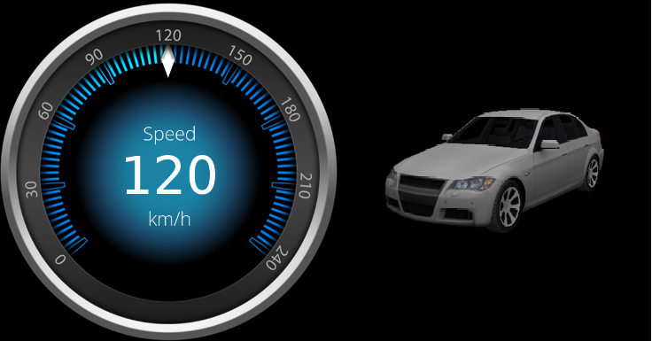

Multi Frequency Rendering allows using different update rates for multiple render targets. For example
- Fix framerate for tubes.
- Adaptive framerate for center use case.
- Details of entire content are preserved.

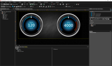

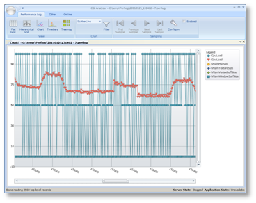

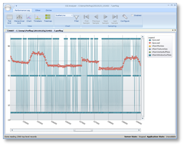

| CGI Analyzer | SceneComposer | Application |
| CGI Analyzer determines benchmark values for each node of a scene given. The benchmarks are exported to a *.crsms file. | The benchmarks are assigned to nodes benchmark property. SceneComposer stores nodes incl. benchmark values in Asset File. | The Application renders multiple cameras with different framerates with help of Benchmark-CameraRenderStrategy. |

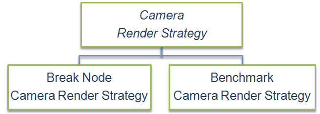

Both, Candera::BreakNodeCameraRenderStrategy and Candera::BenchmarkCameraRenderStrategy are concrete implementations of the interface Candera::CameraRenderStrategy to cover most typical Camera render pass partitioning.

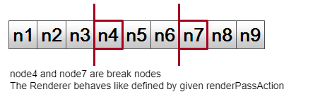

Splitting Render Pass on specific Break Nodes
The Candera::BreakNodeCameraRenderStrategy is populated with a list of arbitrary break nodes.
Defined by RenderPassAction a break node can pause or stop a Camera render pass, if encountered.
breakNodeStrategy = new BreakNodeCameraRenderStrategy(); breakNodeStrategy->AddBreakNode(node4); breakNodeStrategy->AddBreakNode(node7); breakNodeStrategy->SetRenderPassActionOnBreakNode(renderPassAction); camera->SetCameraRenderStrategy(breakNodeStrategy);

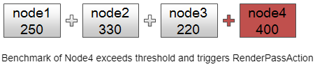

Splitting Render Pass on Benchmark Threshold Values
Each node has a benchmark property that describes a custom reference value for render duration.
During Camera render pass benchmarks are accumulated until threshold of Candera::BenchmarkCameraRenderStrategy is reached. RenderPassAction defines to suspend or stop render pass.
benchmarkStrategy = new BenchmarkCameraRenderStrategy(); node1->SetRenderBenchmark(250.0f); node2->SetRenderBenchmark(330.0f); node3->SetRenderBenchmark(220.0f); node4->SetRenderBenchmark(400.0f); node5->SetRenderBenchmark(390.0f); benchmarkStrategy->SetThreshold(1000.0f); benchmarkStrategy->SetRenderPassActionOnThreshold(renderPassAction); camera->SetCameraRenderStrategy(benchmarkStrategy);

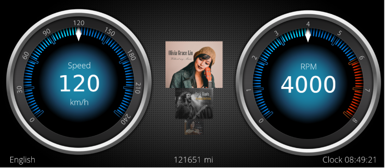

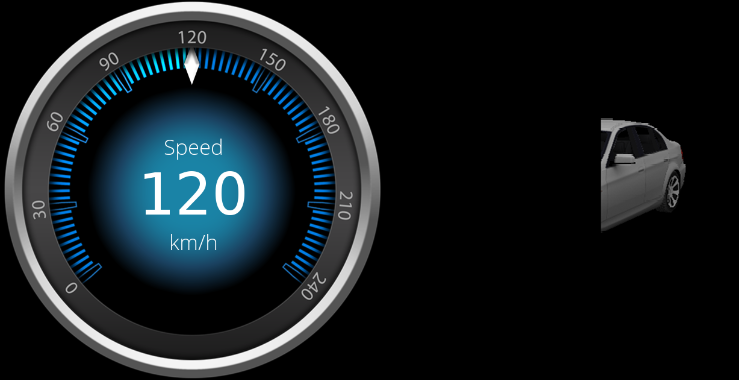

Example: Different Frame Rates for several Cameras
- Fix framerate for speedometer.
- Adaptive framerate for car.
- Details of entire content is preserved.
Cycle 1
Cycle 2
