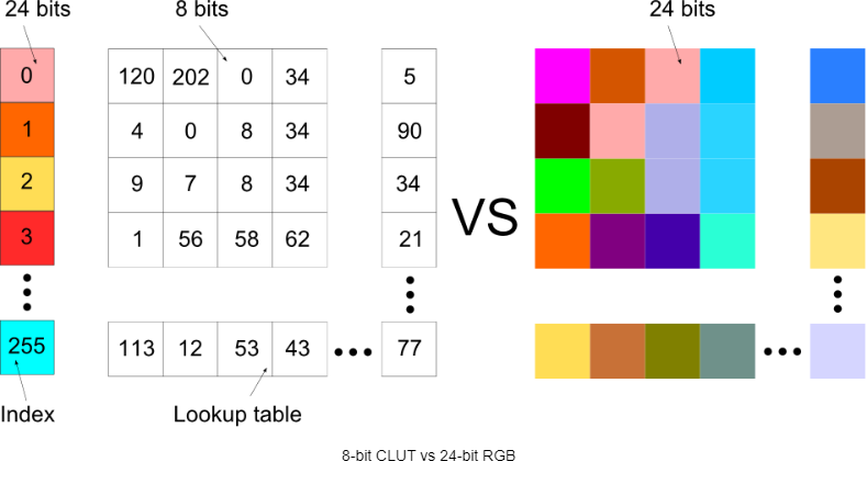

A color lookup table (CLUT) is a table which associates a numeric pixel value with a color to be displayed on the output device. The color is typically specified as a mixture of varying levels of alpha, red, green, and blue, and thus a color lookup table will usually contain three or four components for each possible pixel value. The number of entries in the palette determines the maximum number of colours which can appear simultaneously in the bitmap. Changes to the palette affect the whole image at once and can be used to produce special effects which would be much slower to produce by updating pixels.
CLUT Example
For instance, if a CLUT bitmap has a palette of 256 available colors, the index can be represented by an 8-bit value. The color table is then used to lookup a corresponding 24-bit color value (eight bits of red, green, and blue). Thus, comparing to a full RGB color bitmap, the CLUT bitmap size is roughly one-third.
The key to the efficiency of the indexed color approach is limiting the number of colors that can be represented.
