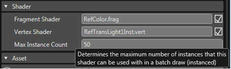

Use an instanceable shader
The shader of an object must support instancing. See this section for a detailed explanation.
If a shader was recognized as instanceable by SceneComposer, "Max Instance Count" listed in the Properties of the Shader is bigger than one. The shader in the following example is able to draw batches of up to 50 instances.

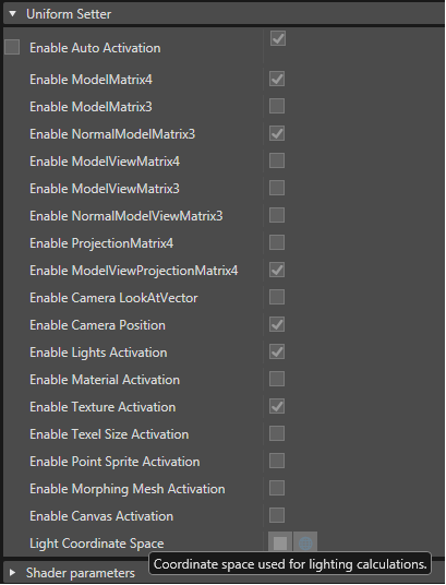

Configure the Uniform Setter
If the shader uses lighting, the Light Coordinate Space must be set to World.

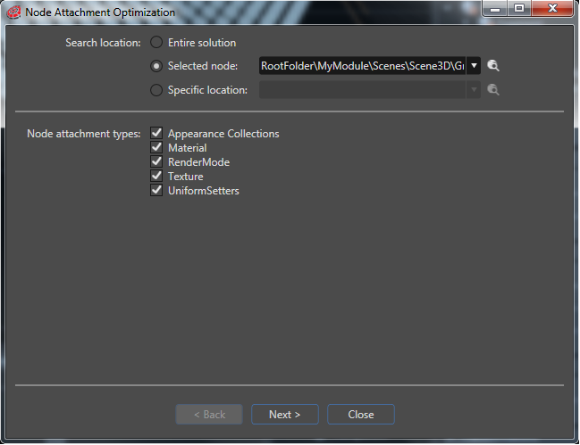

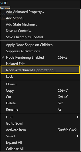

SceneComposer offers the option to optimize asset usage by identifying assets that are identical and substituting these assets by a single shared instance. After selecting a node or a group, and pressing the right mouse button, the following context menu will appear:
Selecting "Node Attachment Optimization" will launch the following window, where you can select which assets should be optimized, and initiate the optimization:

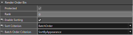

Sort Render Order Bins using the Batch Order Sort Criterion
To maximize the batching rate, use "Batch Order" as the Render Order Bin's sort criterion.
If the scene uses a lot of different appearances (e.g. with different Materials), that share a shader, render mode, and textures, the batch order criterion "SortByShaderAndRenderMode" might achieve a better batching rate then "SortByAppearance". Use the Renderer Statistics to verify which criterion works best with the given content.

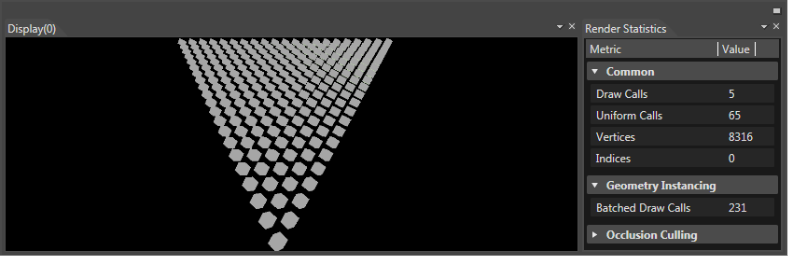

Renderer Statistics
The Renderer Statistics window (which can be opened via View->Renderer Statistics), provides per frame information about what is being drawn by the cameras in the current scene. The values are updated in realtime, and directly correspond to the rendering performed in the "Display" window.
In this example 231 cubes are rendered using 5 draw calls. All 231 cubes are batched (i.e. instanced), therefore they are counted as "batched draw calls".
