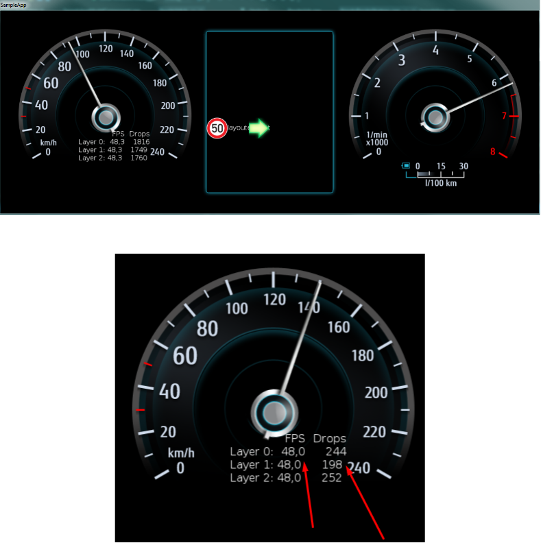

Example of the application running:

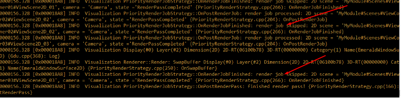

As you can see, the FPS is kept the same for all the layers, but the drops vary depending on the Layer/Nodes/Camera Sequence Number of each render target, some of the render jobs being skipped by the custom sort criteria in the PriorityRenderStrategy class.
In the sample output, red arrows mark skipped render jobs:

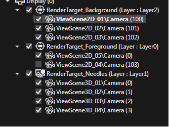

SceneComposer solution

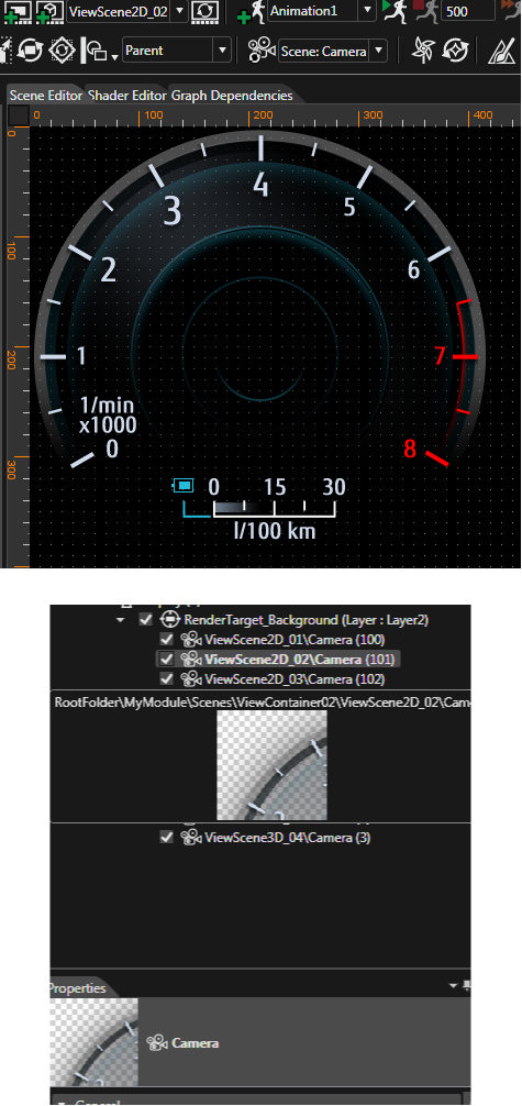

In this demo application, there are three layers: Layer0, Layer1 and Layer2 displayed bellow:
For Layer 2 – which has the most content – the backgrounds, the respective cameras have the highest Sequence Number to have priority being rendered.
