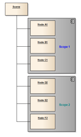

The following scene graph is a simple example where two parts of the scene have different scopes. Think about a use case where one part of the scene has to be displayed immediately after loading the scene and the second part has to be displayed only later in some special situations. To save time for uploading the content to VRAM not all of the content has to be uploaded immediately.
