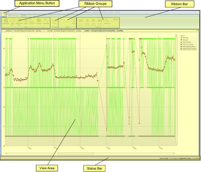

The User Interface is divided in 3 areas:
  • Ribbon bar
  • View area
  • Status bar
The ribbon bar is subdivided into groups of controls dedicated to a specific task - ribbon groups. The View Ribbon Group for example allows configuring the display of, opening of, and switching between views.

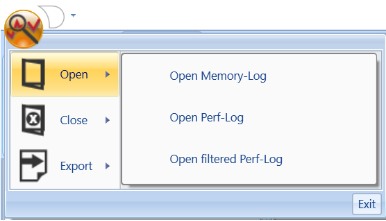

Application Menu
The application menu holds commands for opening and closing a performance log, as well as exporting performance log data.

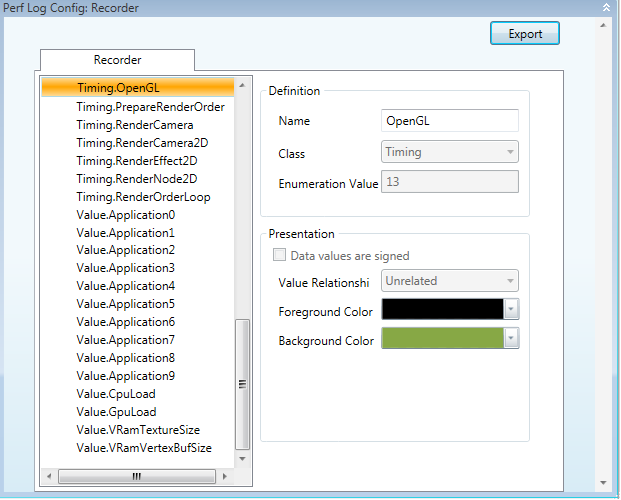

Configuration
The display of performance logs can be configured using the Performance Log Configuration dialog. The dialog can be opened from the "View" Ribbon Group.
The configuration dialog (depicted in Figure 4) allows the configuration of recording appearances in views as well as how the recordings are interpreted.
On the left side of the dialog, there is a list of all recorder names used. The recorder names displayed are fully qualified, consisting of the recorder class as prefix and the display name of the recorder. On the right side, the properties of the currently selected recorder are displayed and can be changed.
Changeable for all recorders are the following properties:
  • Name: The name of the recorder displayed in all views
  • Foreground color: Text color for recordings in Time Bars View
  • Background color: Background color for recordings in Time Bars View, Color for trajectory of recordings in Chart View
Changeable properties for value recorders are:
  • Data values are signed: The displayed values are treated as signed values
  • Value relationship:
    > Unrelated: Recorded values are unrelated
    > Differential: The recorded values are only the difference from the last recorded value, not the total (absolute) value.
    > Absolute: The values recorded are always equal to the absolute values.

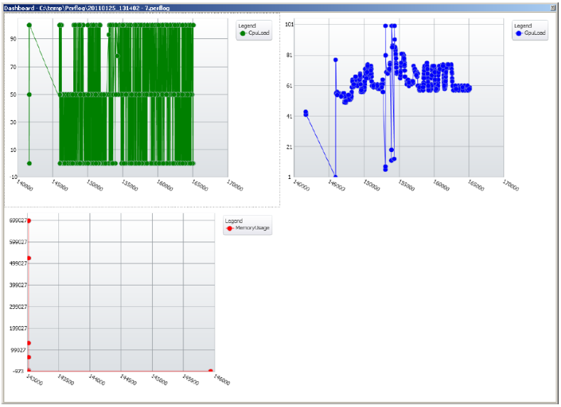

    Performance Dashboard View
    The Performance Dashboard View is the first view, automatically displayed when opening a performance log. It displays recordings of up to four Value Recorders. The actual Value Recorders used here can be customized. After installation, however, CPU load, GPU load and memory allocations are displayed (if available). The figure shows a typical Dashboard View.
    For every chart, the x-axis represents the elapsed time and the y-axis a value scale. To the right of each chart, there is a legend for the values displayed in this chart. There are no interactions possible with this view type. Only the values are displayed upon hovering over graphs.

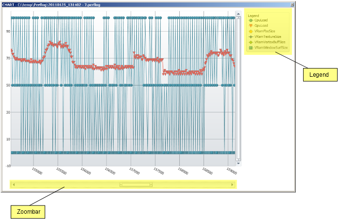

    Chart View
    A Chart View, as shown in the figure displays only Value Recordings.
    On the x-axis, a time scale is displayed, on the y-axis a common scale for all values. To the right there is a legend for the values currently displayed.
    Below the x-axis and to the right of the y-axis, there are so-called zoom bars. They allow the user to zoom-in to as well as pan the chart. Panning is also allowed by left-clicking the chart and dragging it to the left or the right.
    By pressing the left shift button, clicking the left mouse button, and dragging the mouse, a part of the chart can be selected for zooming in.
    Hovering over a trajectory or a marker displays a tooltip with information about the corresponding value.

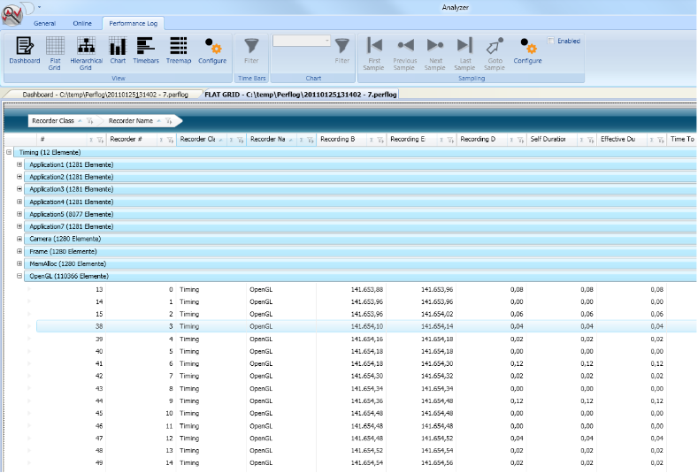

    Grid View
    Flat and Hierarchical Grid Views allow display of all recordings in a grid similar to Microsoft Excel. Table 1 lists and explains the displayed columns.

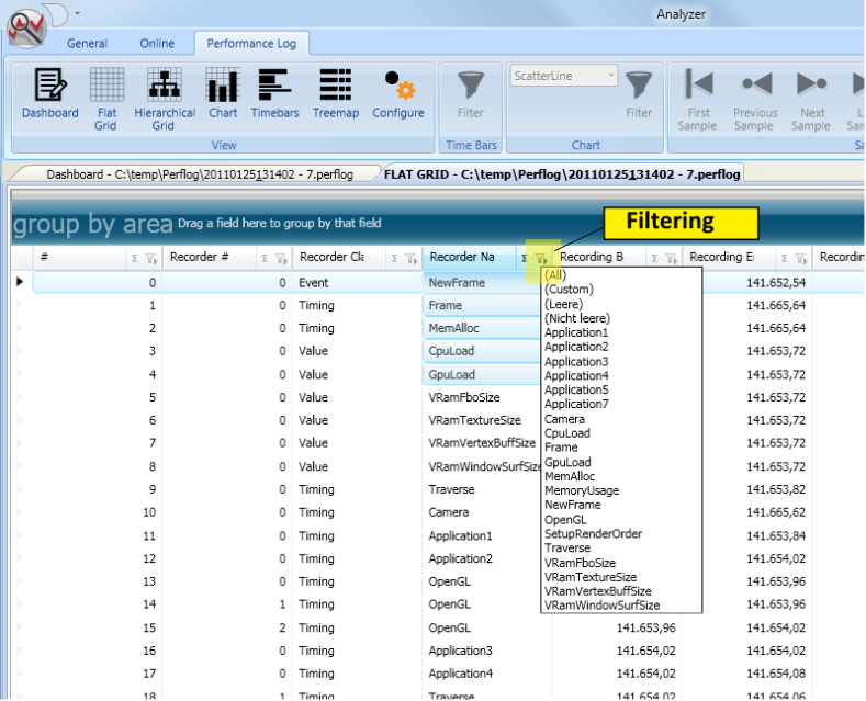

    Filtering
    Filtering in the grid views is available via the grid column headers as depicted in Figure 11. The filtering options are:

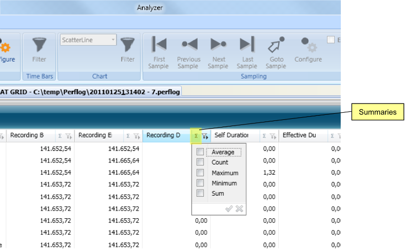

    Summaries
    Summaries are small evaluations over values in one column. Summaries can be en- and disabled via the grid column headers.

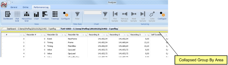

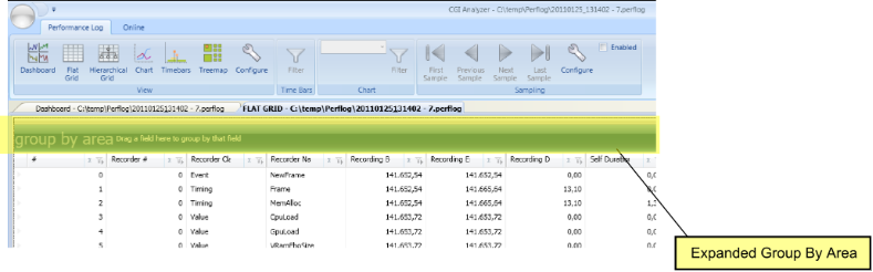

    A grouping is a planned arrangement of all recordings by values in one column. Using this feature, it is possible to impose a hierarchical structure on the recordings. Grouping is accomplished by dragging a column header to the group-by-area. By default the group by area is collapsed.
    In order to restore the group by area, left-click on it or drag a column header and drop in on the collapsed group by area.

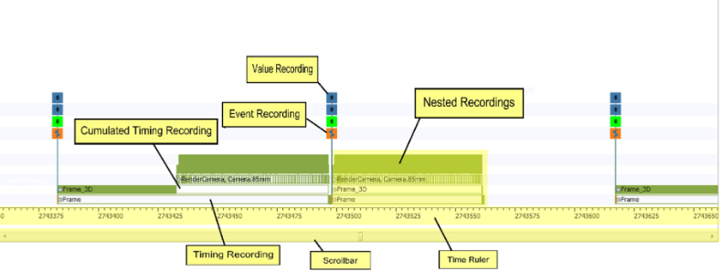

    Time Bars View
    Time Bars View displays all recordings arranged along a timeline. Below the actual time bars, there is a scrollbar for panning the displayed time frame. The time ruler is situated between time bars and the scrollbar. Here, time values in milliseconds and a cursor with the current time under the mouse pointer are displayed.
    These icons are used to distinguish the different recorder classes:

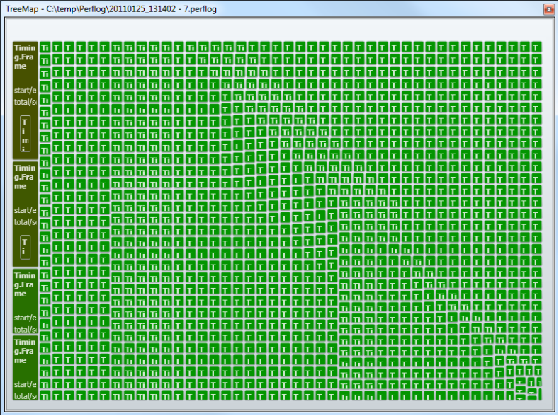

    Treemap View
    The Treemap View only displays timing recordings along with their nesting. The following figure depicts the Treemap View of a performance log.
    This view shows all timing recordings ordered by decreasing recording duration. The timing recording with the highest performance impact on one nesting level is drawn in the upper left corner, the recording with the lowest impact in the lower right corner.
    Left-clicking an item in the treemap drills into this item. Right-clicking an item returns to its parent.
