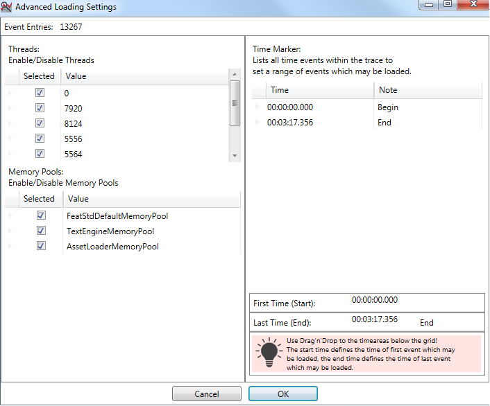

Loading data
All logfiles can be loaded by clicking the application menu button -> open -> Open Memory-Log or by Drag'n'Drop.
When loading a binary log file, a loading window will open after preanalyzing the content of the log file.
This window gives information about the logfile and allows to prefilter the dataset.
It is possible to:
- Disable threads
- Disable memory pools
- Set a time range based on all recorded time marker. Use Drag'n'Drop to place a time marker on 'Start' or 'End'.
Large log files may slow down the analyzer drastically. The MemoryPool-Analyzer settings contains a property to set a cap for maximum loaded entries
