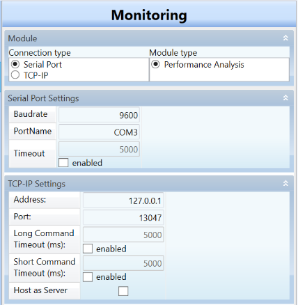

Configuration
The communication server is configured using a configuration dialog accessed through the "Configure" button on the Server Ribbon Group. Figure 20 shows the configuration dialog for TCP/IP connections.
IP-address and port, where Analyzer should listen for incoming connection requests have to be set.
Timeouts can be set in order to prevent the user interface from freezing indefinitely if the communication fails. Disabling these timeouts completely can lead to freezes and communication failures depending on application type, communication type and stability of connection.

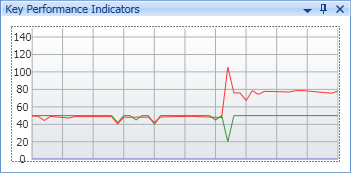

Trend View
The Trend View shows successively recorded key performance indicators such as
  • CPU load (if available)
  • GPU load (if available)
  • Frame Rate
It can be displayed via the View Ribbon Group of the Online Ribbon Tab.
The following shows a Trend View for a host simulation. The color assignment for the performance indicators is currently fixed and as follows:
  • Frame Rate (red)
  • CPU load (green)
  • GPU load (blue)
Mouse over the Trend View shows a clear button which resets the view.

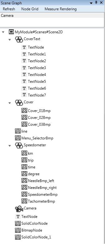

Scene Graph View
The Scene Graph View allows analysis of the scene graph during paused mode.
This view is divided vertically by a splitter into two sections:
  • A camera list on top and
  • A tree view of a scene graph below.
The tree view shows the scene graph associated with the selected camera in the camera list.
The following commands are available via a toolbar on top of the Scene Graph View:
Refresh:
  • This command is always available in paused mode.
  • Fetches the scene graphs from the Candera application and displays it. Node expansion and selected nodes are preserved.
Node Grid:
  • This command is available in paused mode, if a camera was selected from the camera list.
  • Displays all information transferred for the scene graph of the selected camera in a grid.
Measure Rendering:
  • Measures the rendering times of individual nodes and displays the render times along with static scene graph information in a grid
The properties of a selected node are displayed in the Properties View.

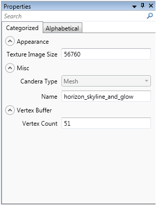

Properties View
Depending on the scene graph node selected in the Scene Graph View, different properties are displayed.
For each node, the following properties are displayed:
  • Name: The name of the node, if available, a blank field otherwise
  • Candera Type: The type of the node (e.g. Mesh or Group)

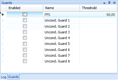

Guards
Guards are a means to switch a Candera application from running to paused mode.
We differentiate between two flavors of guards:
  • Conditional Guards
  • Unconditional Guards
Conditional guards are triggered, when a condition is met. Currently, only one conditional guard (based on measured frames per second) is supported. If the measured frames per second fall below a specified value, the guard is triggered, if it has been enabled, and the Candera application enters the paused mode.
Unconditional guards can be set in application code via the use of the following macros:
#include <Candera/System/Monitor/MonitorPublicIf.h>
MONITOR_FORCE_PAUSED(groupId)
Guards are combined in guard groups. Each guard group has a unique id (the guard group ids are defined in the include file MonitorTypes.h).
All guards can be en- and disabled. Additionally, the number of frames per second can be set for a FPS guard.

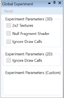

Global Experiments
Experiments allow the user to locate performance bottlenecks by intervening in the rendering process. By targeted change of rendering parameters, conclusions about the origins of performance issues can be drawn.
There are three different groups of experiments:
  • 3D experiments
  • 2D experiments
  • Custom experiments
2D/3D Experiments
The following experiments are available:
  • 2x2 textures (3D only)
  • Null Fragment Shader (3D only)
  • Ignore Draw Calls
The following figure shows the dialog for setting experiments. Currently, experiments can only be en- or disabled in Paused Mode.
Using 2x2 textures
All textures are replaces with a 2x2 texture using a chess pattern.
If the frame rate rises significantly after enabling 2x2 textures, there are likely too big textures in use.
Null Fragment Shader Program
All shader programs are replaces with a default shader program whose fragment shader always produces the color red.
If the frame rate rises significantly after enabling the null fragment shader, fragment shader may be to complex.
Ignore Draw Calls
All draw calls are ignored, thereby simulating an infinitely fast GPU. If the frame rate does not rise significantly, the problem may be CPU-bound.

The analyzer provides a view for global experiments. It contains three different areas for 2D, 3D and custom experiments. To enable or disable an experiment toggle the checkbox. Custom experiments are listed in the same order as they were added to list on target side (see Custom Experiments - Target side: GLOBAL_EXPERIMENT_INIT_CUSTOM_LIST). If the list is wrong or not present, pause the application to update the experiments list.
Additionally it provides a reset button which is used to disable all experiments.
