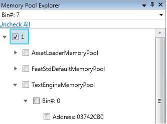

Memory Pool Explorer
The Memory Pool Explorer is used to restrict certain views to a specific dataset. It filters nodewise.
In many usecases the knowledge about a specific node is important.
For example:
  • How much memory were allocated in total?
  • How much memory were allocated per MemoryPool?
  • What is the proportion between these two?
  • What is the difference between two systems?
  • ... The Memory Pool Explorer is the primary way to indicate which nodes have to be compared.
The hierarchy of the explorer is:
  • Systems
    • MemoryPools
      • Bins
        • Blocks
In most cases Systems and MemoryPools are enough to give a rough understanding how two nodes do relate.
However, sometimes it is also important to understand how specific bins or even blocks (addresses) are used.
Therefore all available nodes can be selected individually.
Searching for a specific address can be quite troublesome, so a search bar for nodes exists to make the finding process easier.

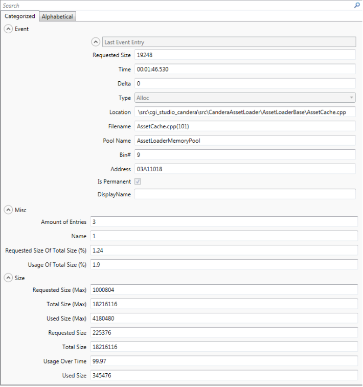

Memory Properties
The memory pool properties view gives a short overview of currently selected nodes.
The reference time for any information provided by the property list is based on the global time slider and its time value.
The properties are divided into three categories:
  • Event: Shows the very last event happened to the selected node(s) and its detailed information.
  • Misc: Gives a brief overview of current selected nodes and statistics.
  • Size: Shows information about the three size values: requested size, used size and total size. Additionally, information about the maximum up until the set global time of each size is given.

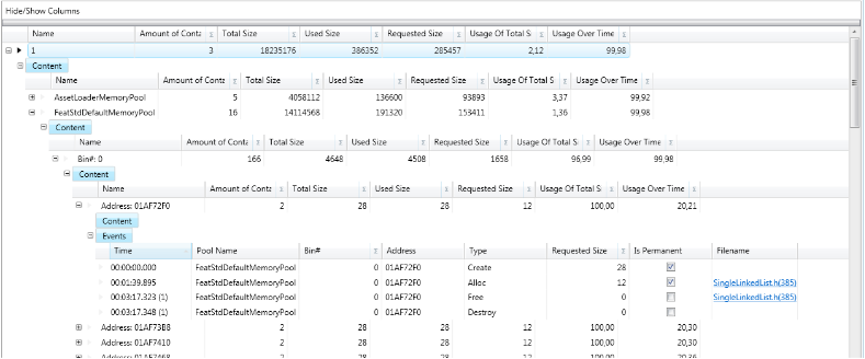

Memory Pool Statistics
The memory pool statistics gives a detailed information about all events occurred on the selected nodes and sub nodes. Additionally the current size related values are shown.
Each node contains two different types of table: A content table and an event table.
The content table gives information about:
  • Name of node
  • Amount of container: How many nodes does this container have?
  • Total size
  • Used size
  • requested size
  • usage of total size: How much size is in use compared to total size in percentage
  • usage over time: how long is a node or one of his sub nodes in use compared to total length of time.
  • Maximum of requested size until global time selected by slider.
  • Maximum of used size until global time selected by slider.
  • Maximum of total size until global time selected by slider.
The event table gives information about:
  • The time when an event occurs
  • The delta time of event. Sometimes more than one event occurs at the same time. To create a chronological order a second time is base is created. The second time base is called delta.
  • Pool name in which the event occurs.
  • Bin number in which the event occurs.
  • Address of block which raises the event.
  • Type of event.
  • Requested size: A creation sets the block size which was created; an allocation sets size of user request. Otherwise its 0.
  • Permanent: Permanent flag of creation or allocation. Destructions and frees do not have this flag, so it’s always not set.
  • Filename: Shows location where event occurred. Creations and destructions do not have a location. Clicking on a filename opens the specific file in a file editor.

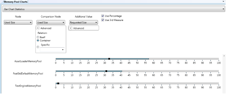

Memory Bar Charts
Accessing the Memory Bar Charts is done by clicking on Memory Pool Charts on the Analyzer ribbon tab and selecting 'Bar Chart Statistics' on the drop down menu.
The Memory Bar Charts are used to directly compare different nodes at a specified time.
There are a total of three different values which can be shown within a single bar chart simultaneously. Any value can be set independent from the others.
The first value always refers to a selected node. The others can show information of the selected node, Information of the node which contains the selected node or a specific reference to a node. When last option is chosen every selected node has the specified node as second reference.
Current comparison values are:
  • Used Size
  • Requested size
  • Total Size
  • Usage over time
The third comparison value is activated when the checkbox is checked.
Another option is to toggle the percentage mode. When this mode is active, relationship between node's value and its comparison value is shown in percentage.

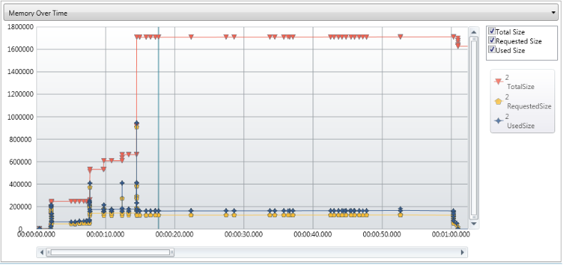

Memory Over Time Chart
Accessing the Memory Over Time Charts is done by clicking on Memory Pool Charts on the Analyzer ribbon tab and selecting 'Bar Chart Statistics' on the drop down menu.
This chart gives a visual overview of the memory behavior over time. All selected nodes are shown within this chart. Every selected node provides three different lines within this chart:
  • Requested size
  • Used size
  • Total size
All three of them can be disabled to concentrate on the currently most important graph. Within this chart is a vertical line which marks the time value selected by the slider.

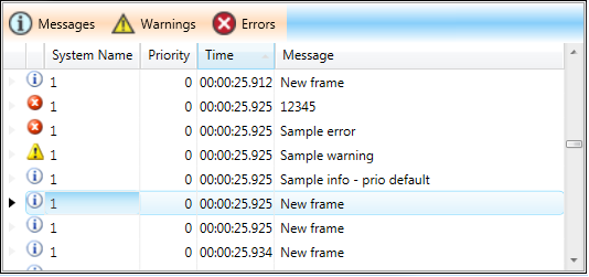

Information list
The info list lists all occurred notification events. A notification event can be an info message, warning or error.
There are three types of info messages:
  • Start key message: Sets a start point
  • End key message: Sets an endpoint
  • Information message
A start key and its corresponding end key, both have to have the same name, are forming a group. An information message may have a priority level. The default priority is set to 0. All three types can be toggled on or off.
