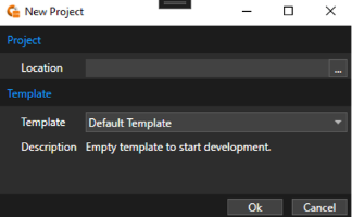

New Project
A new project can be created from the Welcome Screen or via the menu bar (File > New Project) or via the shortcut “Ctrl + N”. This will open additional windows to help setting up the new project.
Template-Selection
In the Template-Selection screen the user needs to first select the location where the new project shall be stored and select which template shall be used as a starting point for the project.
A template usually contains premade application code, build scripts, tooling related files and predefined project settings.

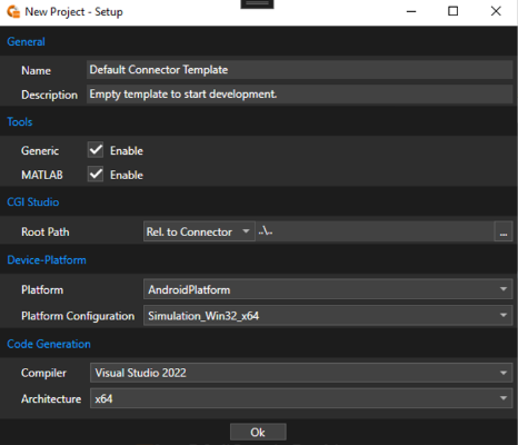

Setup
On the next screen the user can configure the most important project settings.
General
| Property Name | Description |
| Name | Name of the project. |
| Description | Description of the project. |
Tools
| Generic | Enables generic support. This will provide a plain C/C++ interface. |
| MATLAB | Enables support for MATLAB. This will provide additional options/setting related to MathWorks MATLAB support |
CGI Studio
| Root Path | Path to CGI Studio package. The path can be either absolute or relative to CGI Connector/Project paths. |
Device-Platform
| Platform | Name of the CGI Studio Platform (as found in CMake) |
| Platform Configuration | Name of the CGI Studio Platform configuration (as found in CMake) |
Code Generation
| Compiler | Compiler used to build code. |
| Architecture | Architecture used to build the code. |
These, and more, settings can later be changed. For more information, please refer to the “Project Settings” chapter.
