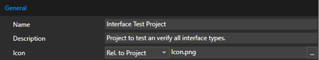

General
Property Name Description
Name
Name of the project.
Description Description of the project.
Icon Custom icon used for the project.

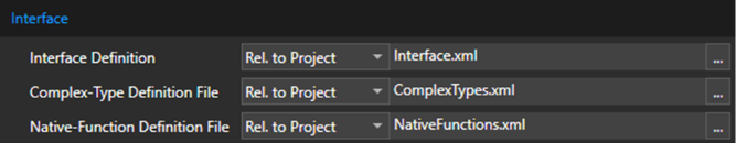

Interface
Interface Definition
File containing the Interface definition. The path can be either absolute or relative to CGI Connector/Project/CGI Studio path.
Complex-Type Definition File containing the Complex-Type definition. The path can be either absolute or relative to CGI Connector/Project/CGI Studio path.
Native-Function Definition File containing the Native-Function definition. The path can be either absolute or relative to CGI Connector/Project/CGI Studio path.

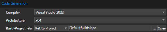

Code Generation
Compiler
Compiler used to build code.
Architecture Architecture used to build the code.
Build-Project File File containing default builds. The path can be either absolute or relative to CGI Connector/Project/CGI Studio path.

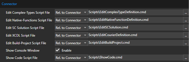

Connector
Edit Complex-Types Script File
Script file executed when editing Complex-Types. The path can be either absolute or relative to CGI Connector/Project/CGI Studio path.
Edit Native-Functions Script File Script file executed when editing Native-Functions. The path can be either absolute or relative to CGI Connector/Project/CGI Studio path.
Edit SC Solution Script File Script file executed when editing SC Solution. The path can be either absolute or relative to CGI Connector/Project/CGI Studio path.
Edit XCDL Script File Script file executed when editing Courier definition. The path can be either absolute or relative to CGI Connector/Project/CGI Studio path.
Edit Build-Project Script File Script file executed when editing a Build-Project. The path can be either absolute or relative to CGI Connector/Project/CGI Studio path.
Show Console Window When enabled, shows a command line window executing scripts. This can be used to debug scripts.
Show Code Script File Script file executed when editing code (via the log window). The path can be either absolute or relative to CGI Connector/Project/CGI Studio path.
