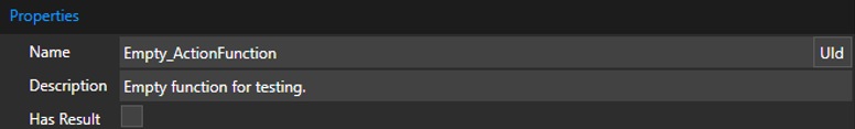

On the left side, Native-Functions can be added/removed and reordered using the respective buttons.
Properties:
Property Name Description
Name Name of the function. This name must be a valid C/C++ name and must be implemented in the Action-Context.
UId The UId is used to identify the native function. It can be seen as the tooltip of the ‘UId’ button. When the button is clicked a new UId will be generated.
Description Description of the function.
Has Result If enabled, the function must return a bool value. This indicates that the function is used for Function-Call Events. The return value will indicate if the related event has been raised or not.
