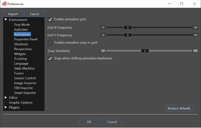

Enable animation grid

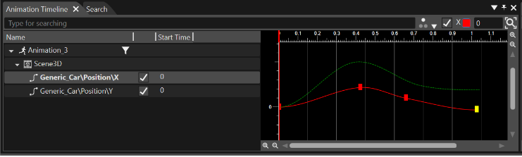

The animation grid represents a collection of lines at a configurable step size for each axis (Grid X Frequency and Grid Y Frequency) that is rendered in the background of the CurveEditor of the AnimationTimeline panel.
Grid X Frequency
If [Enable animation grid] is enabled, set the interval for displaying the animation grid along the X axis.
Grid Y Frequency
If [Enable animation grid] is enabled, set the interval for displaying the animation grid along the Y axis.
Enables animation snap to grid
The "Enables animation snap to grid" option enables the keyframes to become aligned to the grid when being translated in the Curve Editor of AnimationTimeline panel.
Snap Sensitivity
If [Enables animation snap to grid] is enabled,  set the desired sensitivity (the range is the distance to guideline where the keyframes stick to the grid).
Snap when shifting animation keyframes
If enabled, animation keyframes can be set in units of 5 frames on the animation timeline. If disabled, they can be set in units of 1 frame.
