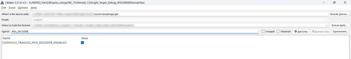

If the JPEG Decoder Behavior is being used, ensure that the JPEG Decoder feature has been enabled in the CMAKE options. While generating the project for target, turn on the CMAKE flag CGIDEVICE_TRAVEO2_JPEG_DECODER_ENABLED or add this flag to the toolchain file.

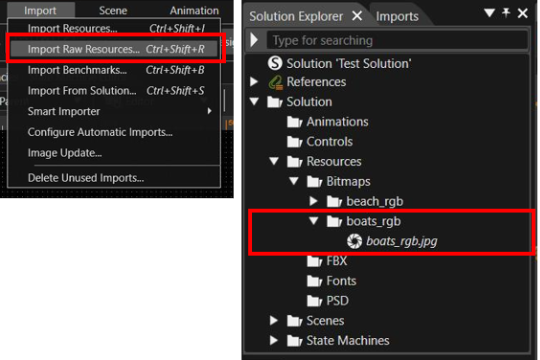

  1. Import the jpeg image as raw resource: Using the import menu select “Import Raw Resources”. This ensures that the image is available in its original format for further processing

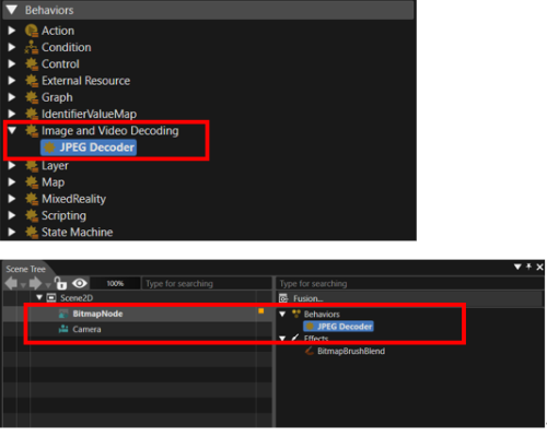

  2. Add the Bitmap node to the scene: Add a bitmap node to a 2D scene.
  3. Add the Behavior to a Bitmap Node: Place the JPEG Decoder behavior onto a Bitmap Node in the scene.

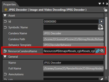

  4. Set the Resource Candera Name: Paste the Candera Name of the raw JPEG image into the Resource Candera Name property using the steps below.

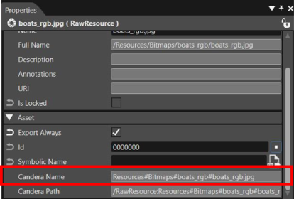

    a. Step 1: Copy the Candera Name of the raw JPEG image from the Solution Explorer under the Asset properties of the JPEG resource.
    b. Step 2: Paste the Candera Name into the ResourceCanderaName property of the JPEG Decoder Behavior in the Properties panel.
