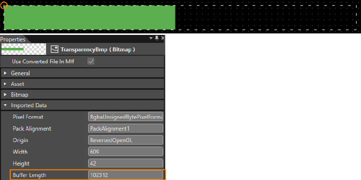

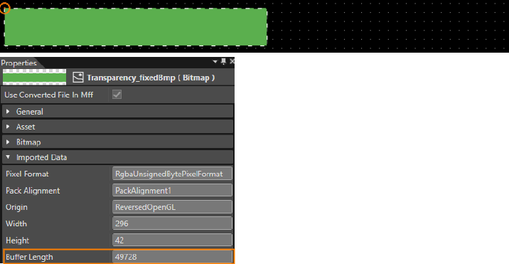

  • Cut off transparent area in the bitmap before usage.
Bitmaps that contain transparent areas
<Origin>
<Improved version>
Bitmap size difference: 102312 ⇔ 49728!

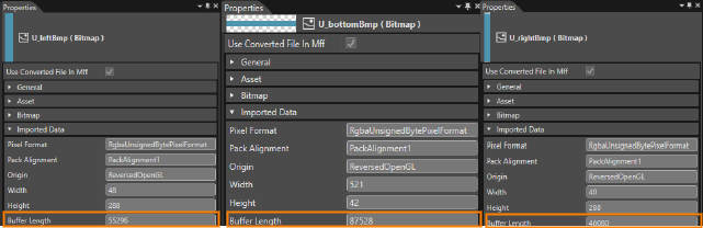

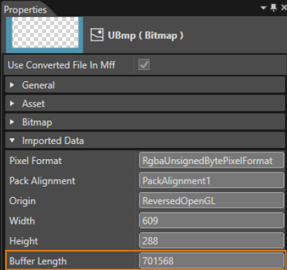

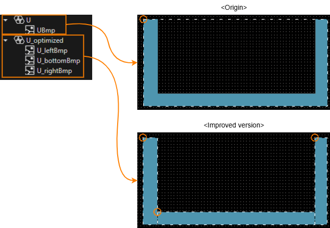

Modify bitmaps with large transparent areas ("U" shape)
<Origin>
<Improved version>
Bitmap size difference: 701568 ⇔ 188904 (55296 + 87528 + 46080)!

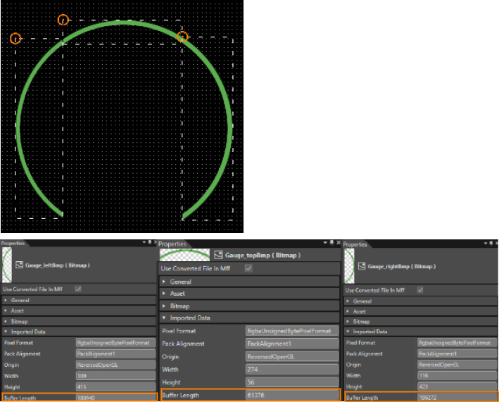

Modify bitmaps with large transparent areas (Gauge)
<Origin>
<Improved version>
Size difference: 925848 ⇔ 438588 (180940 + 61376 + 196272)!

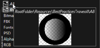

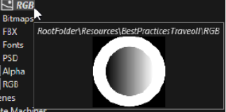

Single-colored bitmaps
For single-colored bitmaps use BitmapBrushColorBlend and use an alpha only color format e.g. A8 or A4. If further size reduction is required there are also compressed formats but those prohibit scaling and rotation on all types of LBO render targets.
<Origin>
<Improved version>
Visual result:
size reduction: RGBA: 222028 ⇔ 74092!

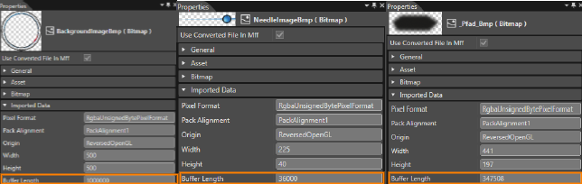

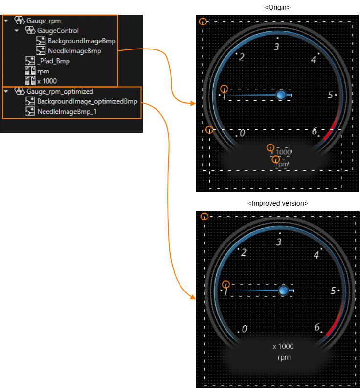

Combine Bitmaps
Bitmaps can be combined to one bitmap at design time. E.g., tube, scale, and numbers should already be combined if possible.
Reduce number of objects from 5 to 2. Avoid rendering of non-translatable static text. Only one moving object left and maybe the gauge itself can be put into a background image.
<Origin>
<Improved version>

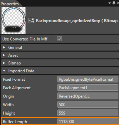

Bitmap size reduction: 1383508 (1000000 + 347508 + 36000) ⇔ 1154000 (1118000 + 36000)!

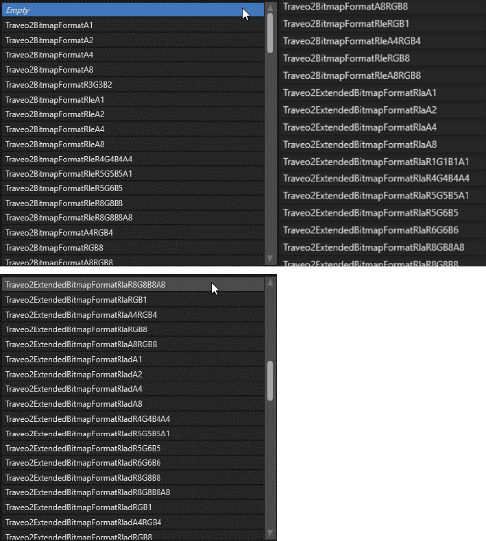

There are many different bitmap formats available for Traveo2. The goal is always to use a format which uses least memory as possible. The drawback is that some formats have restrictions regarding transformation (rotation, scaling, …).
Best practice is to use RLE formats to reduce memory size. AX (A1, A2, …) formats are used to reduce memory further if just recoloring is needed (white or grayish bitmaps can be recolored in CGI Studio).
If a channel (RGBA) has less than 8 bits you will have a lossy compression.
For special use cases there are formats which can dither bitmaps (Nq, Mc, Nq_FsDithered, Mc_FsDithered. Based on the look and feel on the target, usually different formats of such type must be tested to decide what to use.

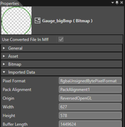

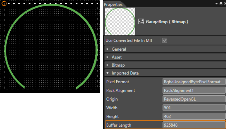

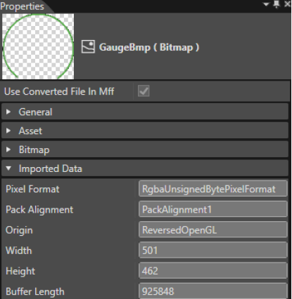

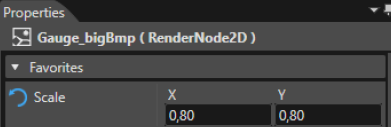

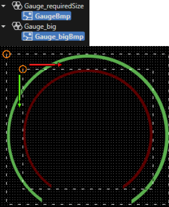

Best practice Scaling and Rotation:
  • These operations require reverse lookup and therefore need more bandwidth and compute power than a simple BLIT. If not necessary, avoid these.
  • It is better to use images with already corrected dimensions instead of scaling down.
The red gauge should be the required size. The green scale is too big and must be scaled down by to 80%.
Needed size of gauge will be 925848
<Origin>
<Improved version>
Bitmap size comparison: 1449642 ⇔ 925848!

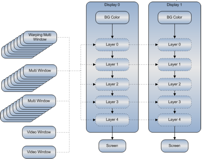

In general, there is always a tradeoff between performance (incl. memory band-with) and memory consumption (e.g., VRAM). Traveo II allows, with the new introduced “Layer-modes” IBO, LBO and OTF, to steer in one of these directions.
Traveo II supports (like Cypress Amber) a huge amount of “separated” Layers, up to 5 “Main-Windows”, 3 of the windows can be split up to 8 sub-windows.
Large area screens shall always be split up to several sub screens to save VRAM consumption.

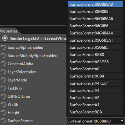

SurfaceFormat optimization
Before starting the project, it must be decided which format could match the expectations of a customer. If less bits per pixel are sufficient for the look and feel it should be chosen to save VRAM. Keep in mind that for overlapping Layers/RenderTargets an Alpha-value is necessary, otherwise no blending of layers is possible.

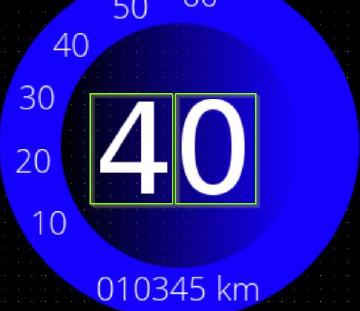

Best practice for drawing text related content:
  • Always pre-render / rasterize non-translatable text.
  • Use static pre-rendered numbers instead of rendering numbers as text (e.g., for Speedometer, RPM, Odometer, ...) Especially for speed use a behavior to switch prerendered digits instead of rendering a text.
    Switch prerendered images instead of text
    Numbers are combined in one image
    Each number as TextNode

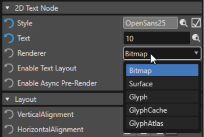

  • Text cache type can balance RAM and CPU use. Use no cache if less RAM is available or use bitmap cache if you have enough RAM. The default cache type is set to Bitmap:
