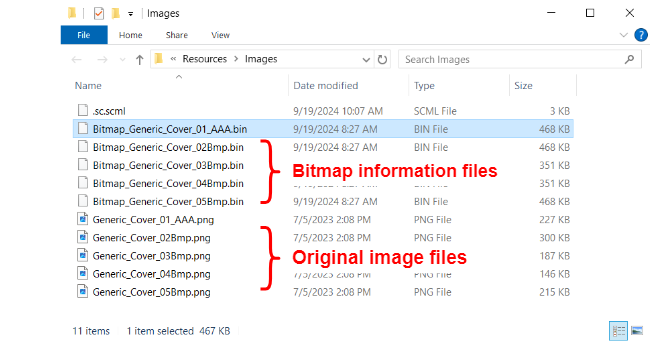

Original image file retention
When an image file is imported using the File menu [ Import > Import Resources ], the original image file is retained along with the bitmap information file (*.bin file) used in Scene Composer.
The original image file is not retained if the file format is FBX, glTF and so on, or if the file is imported using the Smart Importer.

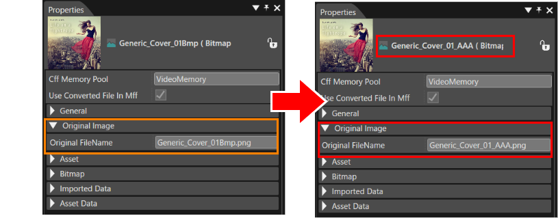

Original image file name
The original image file can be found in the [ Original Image ] section of the Properties panel of the imported resource. The original image file name is "the image information name" + "the original image file extension".
When the resource file name is renamed in Solution Explorer, the original image file name is also renamed.
Original Image File Location

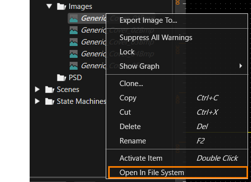

Solution Explorer displays only the bitmap information file. The original image files are stored in the local Solution folder (the same location as the folder displayed in Solution Explorer).
Select a resource file in Solution Explorer and use [ Open In File System ] from the context menu to view its local location in Windows Explorer.
Moving original image files
When you move an imported resource in Solution Explorer, the original image file is moved along with the locally stored bitmap information file.

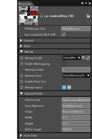

Properties of Imported resources
When you select an imported resource either in Solution Explorer or Import panel, its properties are shown in Properties panel. Information about the selected resource is displayed in Properties panel.

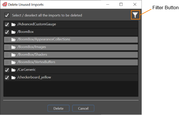

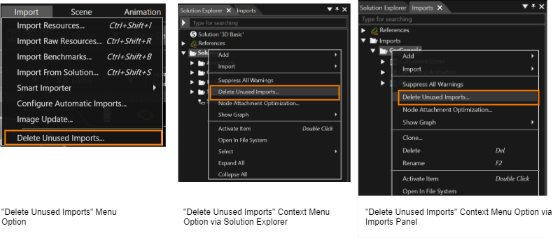

Delete Unused Imports
If there are unused imports or import parts, it is possible to clean up the solution by using the "Delete Unused Imports..." option. This option is available in the
  • Import menu
  • Solution Explorer
  • Imports Panel
The "Delete Unused Imports" dialog will list all the imports from a solution.
Import items that can be displayed and deleted as unused imports are images, raw resources, fonts, fragment shaders, vertex shaders, 3D model files, and scripts.
The filter button allows to hide/show the unused (= undeletable) imports. Tick the checkboxes for unused imports to delete them with the Delete button.
If an import folder contains other folders or files, which are not imported, this folder won't be deleted. Only the imported files that are unused.

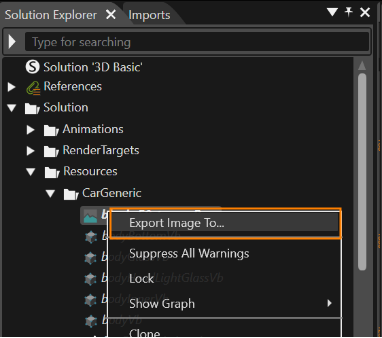

Export Imported Images
If necessary, it is possible to export any imported image from solution to a .png file. This operation can be done through the context menu which is available when right click on any image. This operation can also be performed after selecting multiple image resources.
The image can be exported even though it is locked.

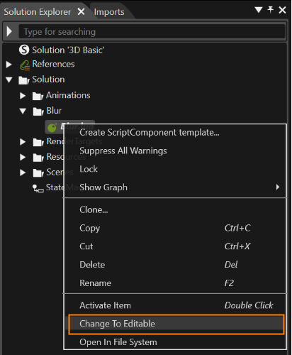

Edit an imported script resource
You can import any type of script by using the [ Import Resources... ] menu. Imported scripts are read-only, but can be changed to editable format.
Select the target script in Solution Explorer and choose [ Change to Editable ] from the context menu.
Please refer to Scripting for instructions on how to operate script resources.
