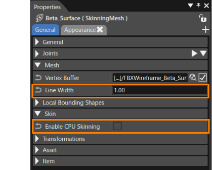

Line Width
It is only added if the [ Import as wireframe ] option is enabled when importing an FBX file that contains skinning. This specifies the line width of the mesh when it is rendered as wire.
  • The actual line width is determined by rounding the specified width to the nearest integer.
  • If the setting is less than “1”, it is always set to “1”.
Enable CPU Skinning
Specifies if CPU Skinning is enabled or not. If enabled, vertex shaders other than those provided for skin can be used with Skinning Mesh.
Note: CPU skinning calculations are slow and should thus be avoided. If enabled, the shader must be edited or configured so that skinning is not done in the shader.

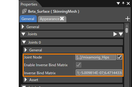

The following property items are set at importing and cannot be changed.
Joint Node Sets a joint node.
Enable Inverse Bind Matrix
Specifies if Inverse Bind Matrix is enabled or not. If enabled, then the joint uses the Inverse Bind Matrix. If disabled, then the joint uses the identity matrix.
Inverse Bind Matrix Used to bring coordinates being skinned into the same space as joint.

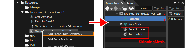

Adding imported scenes
Import of FBX or glTF files, including skinning, is performed using the standard procedure (FBX import procedure, glTF import procedure). After importing, creating new scenes and animations  from the scenes and animations contained in the imported resources.
  1. Select a scene contained in the imported resource and choose [ Add Scene From Template... ] from the context menu.
    • The [ Add New Scene 3D ] dialog will appear.
    • For more information on  the  [ Add Scene From Template... ]  feature, see here.
  2. Make the necessary settings on the [ Add New Scene 3D ] dialog and press [ OK ] button.
    • The scene will be added as a new scene in the Solution Explorer panel, in the Solution>Scenes folder.
    • The scene tree panel will display the added scene.
SkinningMesh is added to the imported scene (red frame in the right figure above).

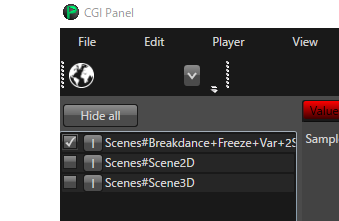

  2. In the CGI Panel, check the target scene from the scene list on the left side.

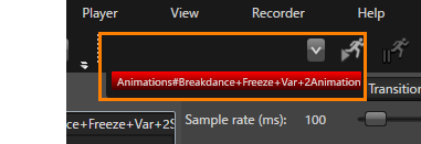

  3. Select the animation to be played from the toolbar pull-down menu.

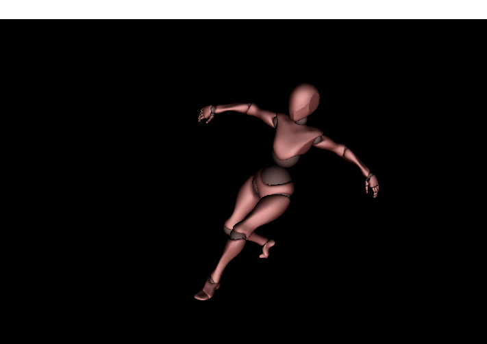

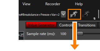

  4. Press the Play button on the toolbar to execute the animation playback.
    • The skinning animation specified in the display panel is played.
