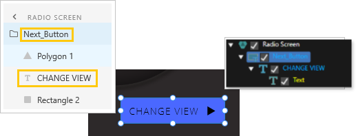

Buttons
If the Adobe XD resource contains a group, the name of which ends with _Button, the Smart Importer will create a TextButton.
Smart Importer checks the suffix in a case insensitive way, so _button or _BUTTON etc. will also work.
The Smart Importer will apply the following properties to the SceneComposer TextButton:
  • Text - The first text label found inside the Adobe XD group will become the TextButton's Text.
The button depicted above, provokes a Scene transition. This transition is taken from the first artboard transition found inside the group (see Transitions).

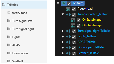

TellTales
Smart Importer creates a TellTale Control for an Adobe XD group, whose name ends with _TellTale. If this group contains an image with OnState or OffState in its name, this image will be set as the TellTale Control's On State Image or Off State Image respectively.
Smart Importer checks the group name's suffix and the image names in a case insensitive way, so _Telltale or _telltale etc. and ONSTATE_picor image_offstate_picture etc. will also work.
Please also see section Tell Tale Control of the Adobe XD import example.

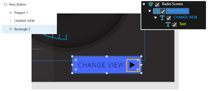

Rectangle
Though there is a polygon in the group "Next_Button" of the sample, that isn't imported into a Solution in Scene Composer. This is because a rectangle shape is only supported for importing.

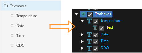

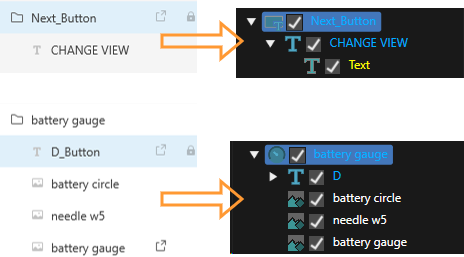

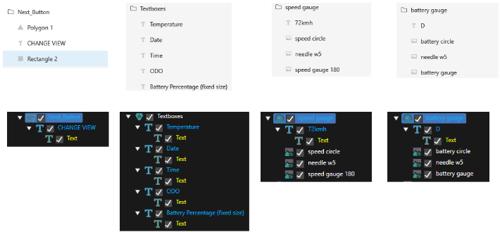

Text Controls
Text layer will be set as Text Control as same as other file format. In this sample, the following layer are text layers.
  • Change view under "Next_Button"
  • The all child layers under "Textboxes".
  • 72km under "Speed gauge"
  • D under "Battery gauge"

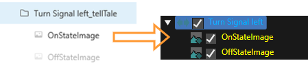

Tell Tale Control
Since there is "TellTale" group in the sample file and that group name has a suffix of "_telltale", its child image layers are set as Tell Tale Control.

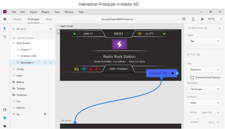

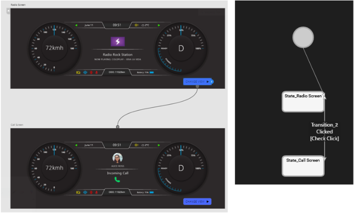

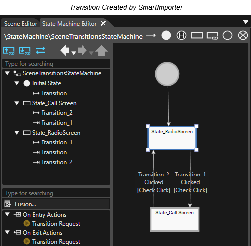

Transition
The transition setting that is created by Adobe XD is transferred to State Machine editor.

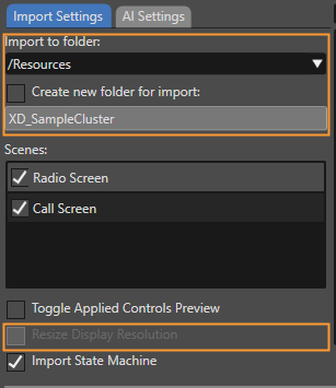

Other options
If necessary, please change the setting on "Import to folder" and its related options. And, mark "Resize Display Resolution" option just in case.

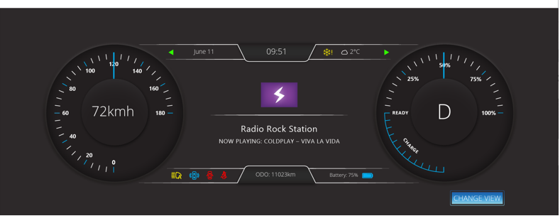

Perform Player
After set the above, press OK button on Smart Importer dialog to proceeding import. Then, press "Play" button with "Generate and Play" option. Player application is run, and uncheck "Scenes#Scene2D" section and then you could get the importing result. If you press "change view" button in the right bottom corner, you can make transition to the other scene accordingly to the transition in Adobe XD.
