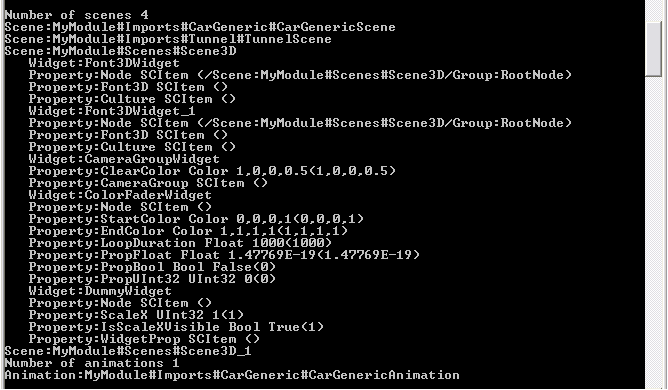

FTCCmd Operation Mode: Info
Use the Info operation mode of FTCCmd to display some basic information about the content of a given solution (for example: the scene contained in the accessed solution, the used animations, the widgets which are used in the given solution and their properties).
C:\SceneComposer>FTCCmd info
Displays a list with scenes and animations contained in a solution.
FTCCmd Info {SolutionFile} [/Convert Yes|No]
SolutionFile The solution file which will be processed.
/Convert Converts the solution if necessary (Yes, No, default No).
C:\SceneComposer>
Example:
FTCCmd Info "C:\Documents and Settings\User\Desktop\Solution\Solution.scs"

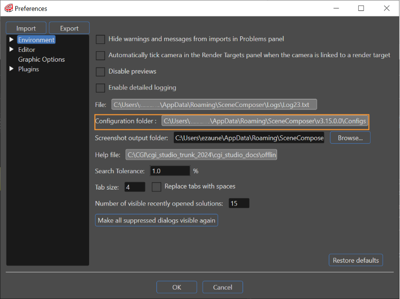

FTCCmd Configuration: /Config
To reuse all the user specific persistent SceneComposer settings in an FTCCmd session, use the /Config argument to specify the path to the SceneComposer configuration folder.
The configuration folder valid for a given SceneComposer GUI session can be found in "File" > "Preferences" section "Environment":
Instead of the full configuration folder, an exported .sccfg file can also be used as a /Config argument value. Use the "Export all" button to create a .sccfg file.
Examples:
FTCCmd ... /Config C:\Documents and Settings\...\... FTCCmd ... /Config FTCSettings.sccfg
