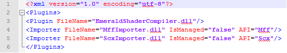

To keep the things well organized, the best options is to have all the plugins in one place. The Plugins.xml fileway allows to distinguish if it is native/managed and for native if it is mff(old)/scx(new).
If this file is missing the native/mff importers will loaded from ".\Importers" and the managed plugins will be loaded from the folder ".\Plugins" as it was in the previous versions. If the configuration file is present, only the specified plugins will be loaded. A sample configuration file is delivered with SceneComposer.
