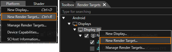

A new render target can be added using one of the following possibilities:
Go to "Platform" > "New Render Target" in the menu bar or go to the Render Targets panel, right click on a node under the display and select "New Render Target" from the context menu.

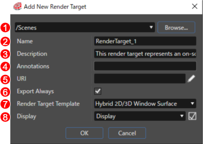

Set the following items in the Add New Render Target dialog box and click [ OK ] to create a new Render Target.
(1) Top input field The location where the Render Target is saved in Solution Explorer
(2) Name The Render Target Name
(3) Description The Render Target Description
(4) Annotations The Render Target Annotations
(5) URI The Render Target URI
(6) Export Always If enabled, the Render Target selected at the time of asset generation is always exported to the asset.
(7) Render Target Template The Render Target template
(8) Display The display that is linked to the Render Target
The types available depend on the SceneComposer platform of a given solution, respectively of the feature set of the Candera Device specified by the platform.

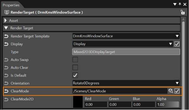

ClearMode
A ClearMode item used to clear the buffer associated with a 3D Render Target.
For instructions on how to create a ClearMode item, see ClearMode.

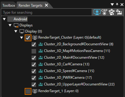

Every new created render target could be enabled or disabled by ticking the checkbox. When deactivating/activating a render target by unchecking/checking the checkbox, the render target gets also unloaded/uploaded. Therefore, one can make use of several WindowSurfaceRenderTarget objects having the same layer by activating only one of them; the others will not be uploaded.

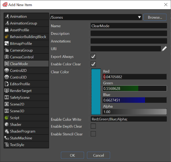

Clear Mode Item
The "Clear Mode" item can be created via "Solution Explorer" panel by using the context menu option ("Add" > "New Item"). In this way, all its specific properties ("Clear Color", "Enable Color Write", "Enable Depth Clear" and "Enable Stencil Clear") are related with just one item instead of being included among many other properties of every render target. If there are many render targets which are referencing the same clear mode item, it is enough to modify just one time the desired property rather than modifying every of them.
After the creation of a "Clear Mode" item, it can be used after being referenced from a specific Render Target. This operation can be done by using the "Clear Mode" property available in the "Properties" panel associated with any available render target.
If a ClearMode is a associated to a RenderTarget, the RenderTarget is cleared using that clearmode before any of the attached cameras renders to it.
