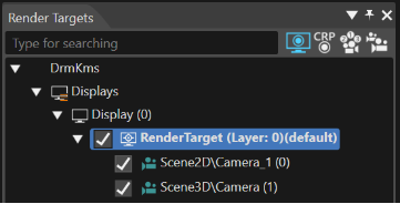

There are two options on how to create a link between a camera and a render target:
- Camera to render target: Drag the camera in the Scene Tree panel and drop it on the desired render target in the Render Targets panel.
- Render target to camera: Drag a render target in the Render Targets panel and drop it on the desired camera in the Scene Tree panel.
Existing links will be overridden by a new drag and drop operation.
Render Targets Panel with Camera enabled
A camera can be associated to exactly one render target at a moment.
A render target can be associated to one or more cameras, hence one or more cameras can use the same render target as output target.

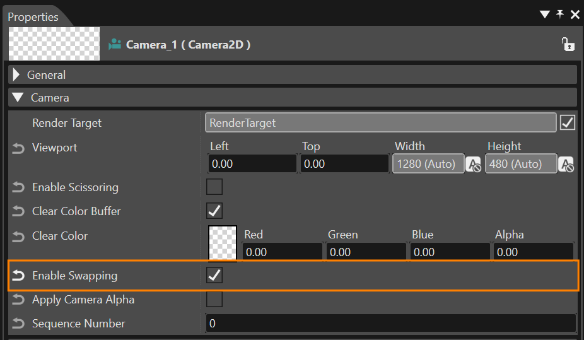

Render Target Swapping
Once all cameras are finished with rendering their content onto a render target, the render target must be swapped. There are two options to ensure this:
- Enable the "Enable Swapping" property of exactly one camera linked to the render target. In case of more cameras, take the camera with the highest sequence numbers, so only the last camera linked to a render target will trigger the swap of the render target buffers.
- If no camera has "Enable Swapping" property enabled, the application must take care to swap the buffers during the render loop correctly.
"Enable Swapping" property of Camera
In case no swapping is done, the display will remain black.
In case more than one swapping is done during a render pass, the display will flicker.

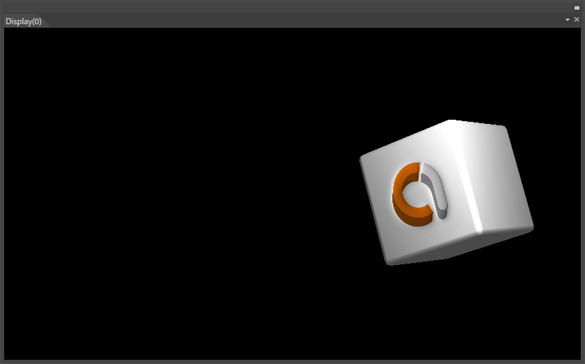

Scene Rendered on a Configured Display

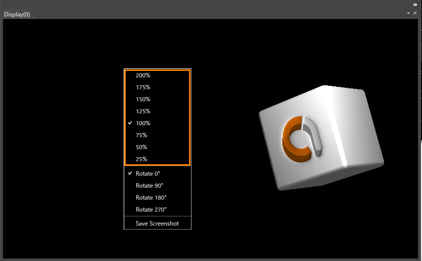

Zoom Display Preview:
In some particular situations, the user could need an option to switch back to 100% of a display if its size has been modified. Consequently, the possibility to zoom in Display Preview through options in the context menu of the view is available. In the context menu which can be opened by right click anywhere in the display, eight given values are available: 200%, 175%, 150%, 125%, 100%, 75%, 50%, and 25%.

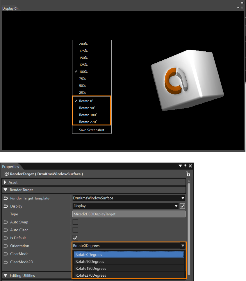

Rotate Display Preview:
This function is used to rotate the orientation of the display preview to match the orientation of the target device (landscape/portrait). The CGI Player also has a similar function. See "Rotate" for details.
The display preview can be rotated in the below two ways.
- Set the rotation angle (0°/90°/180°/270°) from the context menu of the display preview.
- Set the rotation angle (0°/90°/180°/270°) from the Orientation property of the render target. This setting also applies to the rotation angle of the CGI Player.
