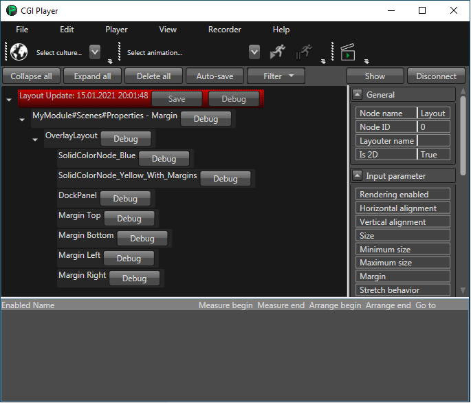

The figure below shows the Layout Monitor user interface.

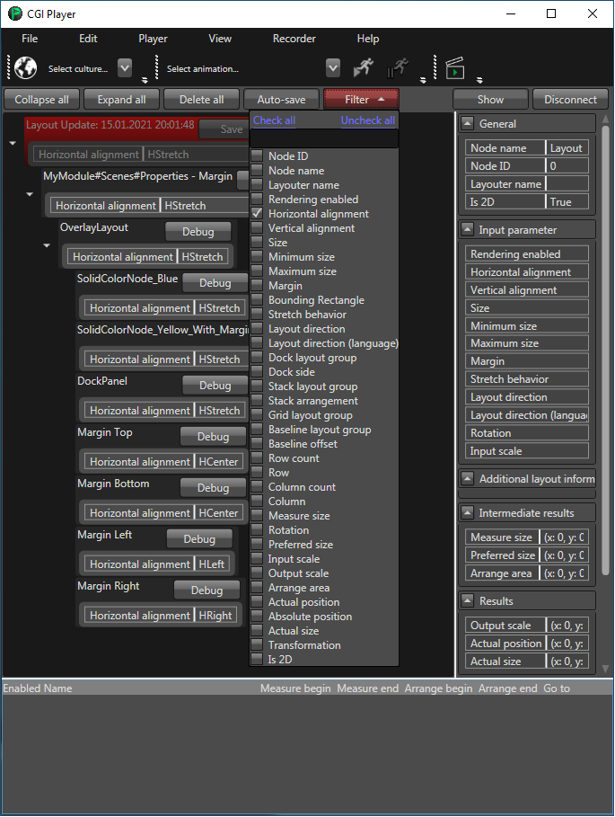

In the middle of the window, all the layout trees are displayed. To customize the view, these can be individually collapsed or expanded by clicking the small arrows to the left of the layout tree. It is also possible to collapse, expand and delete all layout trees by clicking the buttons above them. By clicking the Auto-save button, all incoming layout trees will automatically be saved to a location relative to the application workspace. The individual layout trees can be expended, collapsed and deleted by right clicking on them.
The layout trees can be filtered by clicking the Filter button as well as typing text in the textbox on top of the list. A dropdown list opens that enables choosing from various filters. These can be individually enabled or disabled. By clicking the according options in the list, all of the filters can be enabled or disabled at once as well. If a filter is enabled, it displays the according information inline with the layout tree. The figure below shows the filters available in Layout Monitor.

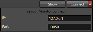

Clicking the Show button to the right shows the according overlay. For more information refer to Information shown in Layout Monitor. Clicking the Connect button connects to the target device. The connection is required always (also on host) and must be enabled before the Layout Monitor is used. The IP-Address and the Port used in connecting can be changed in the Settings window which can be opened by clicking File -> Settings... as well as by opening the drop down menu to the right of the Connect button. For more information refer to Connection Setup.
Connection Setup
A connection to the target or to host can be established by clicking the Connect button to the right of the window. It is possible to adjust the settings of the connection by clicking the dropdown button to the right of it. In the dropdown window the IP address and the Port can be set. After the connection is established, it can receive layout trees.
To produce less network traffic, disconnect and connect again to the target to receive events. This reduces network traffic considerably.

  • The IP-Adress and the Port indicate where the monitor connects to.

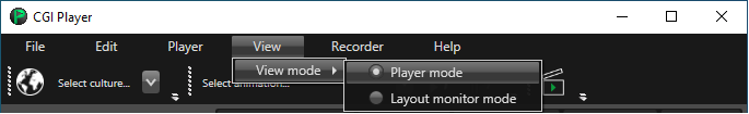

The Layout Monitor mode can be used for applications that do not derive from the Player. These applications do not support all the other interfaces that would typically be required by the Player.
The Layout Monitor can be used in both of the CGIPanel modes:
  • Player mode
  • Layout Monitor mode (standalone mode)
The mode can be selected using the View -> View mode option.

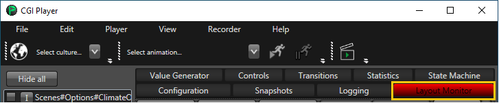

In Player mode, Layout Monitor can be accessed by pressing the "Layout Monitor" button, shown in the figure below.

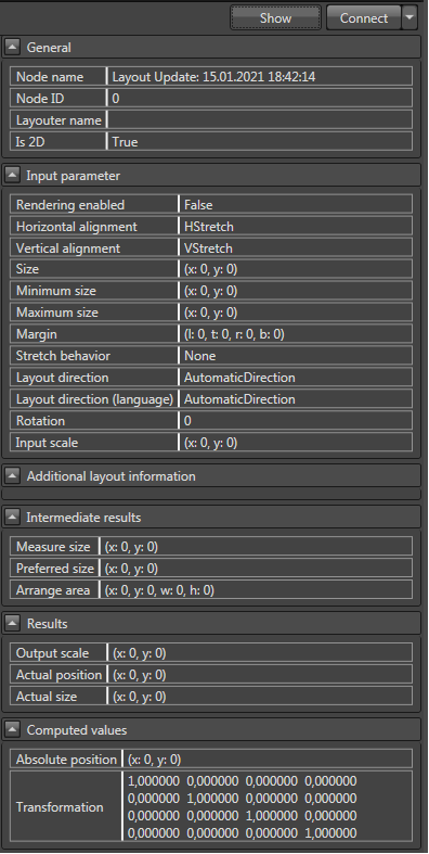

By clicking the Show button, Layout Monitor shows various information of the selected layout tree and also the overlays.
  • The General dropdown field shows general information from the received layout tree.
  • The Input parameter dropdown field shows information set within SceneComposer.
  • The Additional layout information shows miscellaneous information that do not fit in the other categories.
  • Intermediate values are values used as an intermediate result for the end results.
    • For example the Measure size defines the size a node would like to have under specific layout preconditions.
  • The Results section shows the final values that define the node element.
  • The values shown in the Computed values dropdown field are computed directly on the host, not on the target.
For every individual value there is also a tooltip available that explains the values in more detail.

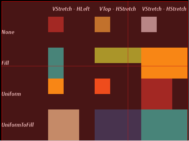

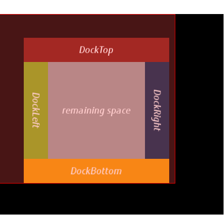

By selecting nodes of the layout tree, differently colored rectangles are shown as an overlay on the screen.
These rectangles are a host-only overlay. If they should be applied to an application displayed on the target, screenshots have to be used. For more information on how to make screenshots, please refer to Player. To use a screenshot with the overlay, show the screenshot and the overlay. Then move the overlay over the screenshot.

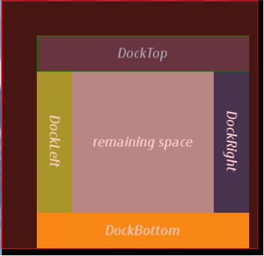

If the top node is selected, a red rectangle appears. This rectangle can be moved freely and is to be placed atop the displayed layout. The top left corner of the overlay should be placed on the top left corner of the Player screen. This is also shown in the figure below. If the mouse is hovered above the rectangle, a tooltip appears that shows its size and position.

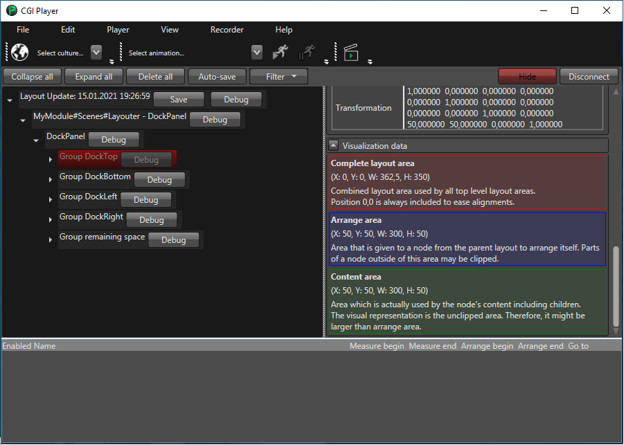

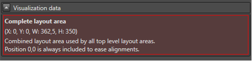

Additionally to the layout, the field Visualization data appears to the right of the user interface. This field shows the size, position and a description of the overlay. To help distinguishing between the different overlays, the different entries in the visualization data section of the informations panel to the right have the same color as the according overlay. In case of the top layer overlay, the field looks as displayed in the figure below.
If a sub-node is selected in Layout Monitor, rectangles appear that display all included parent nodes. As an example, SolidColorNode is selected. Now the Visualization data dropdown field contains three entries of the three shown overlays, their data and their description.
Now there are three overlays that show how the layouts are set.

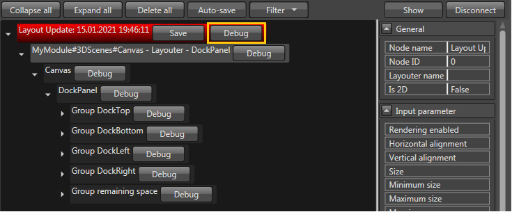

It is possible to debug either individual nodes or a parent node and its child nodes. To do this, simply press the debug button to the right of the node. If the node has child nodes, these will be debugged too.

Clicking the debug button will cause breakpoints to appear on the bottom of the window. In this example, two breakpoints are set.
