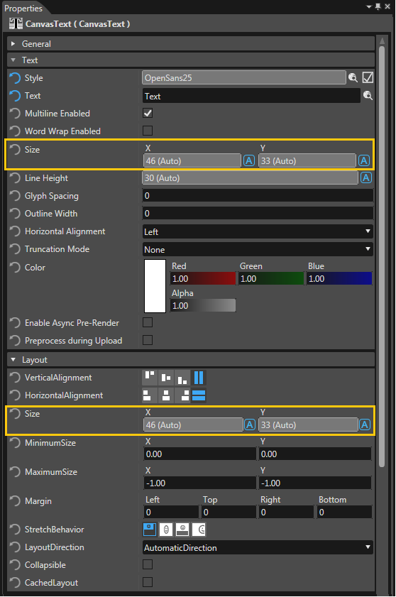

In total there are up to three different size properties on each text:
  1. The Text::Size property
  2. The Layout::Size property
  3. And an additional layout size (e.g. the column width or row height when using a grid layout)
The Text::Size (1.) property itself is mainly used to layout the text (text measuring) and provides text alignment, word wrapping and other text features to applications which have not set layout to enabled via CMake (CANDERA_LAYOUT_ENABLED is not set).
Aside from that, this is the most basic way to define the dimensions in which text is rendered.
For the two layout properties (2. and 3.) it is possible to set only one of them which will result in the same output.
E.g. setting the grid column width (3.) to 100 px is equal to setting the Layout::Size (2.) to 100 px.
However, in the first variant the layout size is bound to the underlying layout, whereas in the second variant it is bound to the text.
If both are set, both will have impact on the layout. The grid column/row size (3.) will have higher priority when calculating the complete layout but the Layout::Size (2.) will still have some impact.

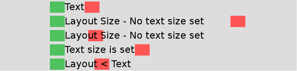

Examples
The following image shows some use cases to provide a better understanding of the layout behavior with different sizes. Every use case is based on a StackPanel with a CanvasSprite, a CanvasText and another CanvasSprite.
  1. Default Text: No sizes set. The text is measured and the result is used for layout.
  2. The layout size is set to a huger value than the text actually requires. This result is expected when the text is smaller than the layout size or the text size is limited to the shown size. The layout size defines the size for the layout in the end.
  3. Same case as 2. But the layout size is smaller. There is no explicit restriction for the text itself.
    Therefore, the layout area is used for the layout process but the text will be drawn overlapping the other nodes of the layout as it requires more space.
  4. Layout size is not set but text size is set to the actual size of the text. The layout uses this size to position the text.
  5. Both sizes are set, but the Text::Size is greater than the layout size.

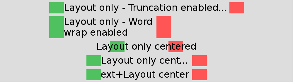

  6. The layout size is set and Text::Size is not. The text would normally write over other elements. However, truncation is enabled.
  7. Same as case as 6. but word wrap is enabled.
  8. The Layout::Size is set and the layout alignment is center. It overlaps other elements but the text keeps being centered.
  9. Same as 8. but truncation is enabled. Now the text is not centered anymore, as it requires more space than available. The beginning of the text is shown until the end of space is reached.
  10. Layout::Size as well as Text::Size is set. Normally, the beginning of the text would be shown. However, the text alignment is also centered. Therefore, the center part of the text is visible.
