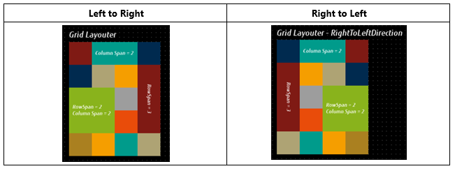

Grid Layouter
If a grid layouter’s Layout Direction property is set to RightToLeftDirection, the horizontal order in which its children are arranged will be reversed. If a child has its Column Span greater than 1, it will span across the cells on its left side instead of the right side.

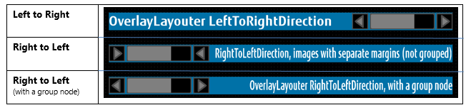

Overlay Layouter
Overlay layouter’s Layout Direction property only has the general effects that all layouters share: its values HLeft and HRight take on each other’s effects and it exchanges left and right margin sizes of its children.
In the example screenshot below an overlay layouter’s children are a text node; two arrow buttons and a bar; and a solid color node with Stretch Behavior set to fill. The left arrow button has its left margin set to 750 (pixels), the bar to 805 and the right arrow to 1010. These left margins becomes the right margins when overlay layouter’s Layout Direction is set to RightToLeftDirection. The third example puts the two arrow buttons and the bar as children of a group node with Layout Direction set to LeftToRightDirection to prevent the three nodes from changing the order. Only the group node’s margin changes.

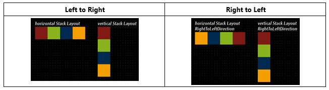

Stack Layouter
With the stack layouter’s Arrangement property set to Horizontal, the layout direction determines the order of its children. When the stack layouter’s Arrangement property is set to Vertical, the layout direction does not affect its children’s order.

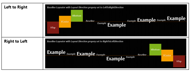

Baseline Layouter
Changing baseline layouter’s Layout Direction property from LeftToRightDirection to RightToLeftDirection reverses the direction in which baseline layouter’s children are ordered. The horizontal alignment is similar to the StackLayouter.

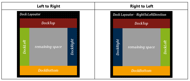

DockPanel Layouter
When changing the layout direction of the DockPanel layouter to RightToLeftDirection, the left and right docks will be exchanged.
