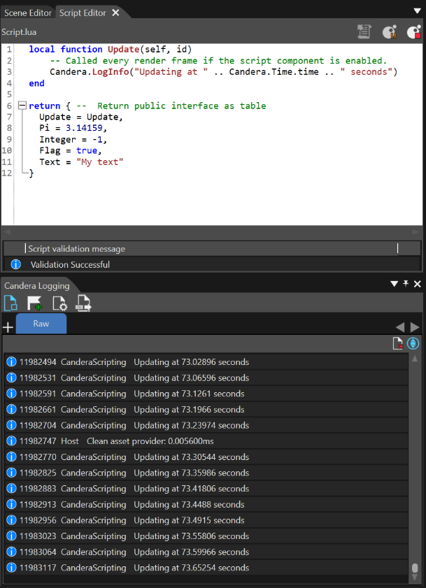

Executing scripts changes the "Start Script System" button in the Script Editor to a "Pause" button:
Executing the script shown in the screenshot produces output in the Candera Logging tab.

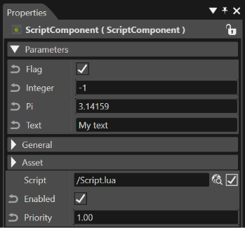

During execution of scripts, their parameters in the ScriptComponent Property tab are updated in realtime to reflect their current values.

When execution of scripts is paused, the parameters in the ScriptComponent Property tab can be edited and will affect script execution once it is resumed. The Enabled flag and the Priority can also be changed in realtime affecting the execution of scripts.

When execution is stopped, the parameters of all script components are reset to their values before execution was started. This includes any changes to parameter values during paused execution, as well as the Enabled flag of the component.
While scripts are being executed, they can be edited in the Script Editor. However they can only be validated when the script system is stopped.
