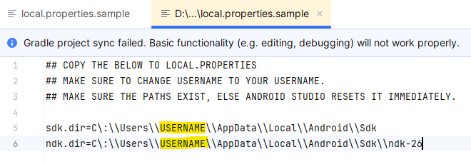

  2. Open the “local.properties.sample” file and change the “USERNAME” in the SDK and NDK path to match the
    system it will be used on.
  3. Copy the contents of the "local.properties.sample" to “local.properties”. Note that if the SDK or NDK paths do not exist, Android Studio will reset the “local.properties” again after trying to Sync Project with Gradle Files.

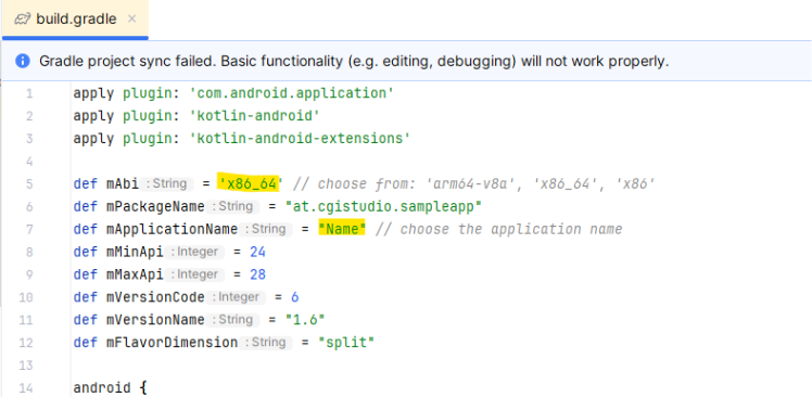

  5. Choose the supported ['arm64-v8a', 'x86_64', 'x86'] ABI "mAbi" and set the application name "mApplicationName" in “build.gradle (Project: Module :app)”.
