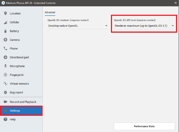

Android Studio Emulator
When using the Android Studio Emulator for testing, ensure that the Android version and ABI match those of the Android application. Additionally, make sure that, for the emulator, the OpenGL ES API level (requires a restart) is set to "Renderer maximum (up to OpenGL ES 3.1)." This OpenGL ES API level can be configured in the Android Studio Emulator's Extended Controls.

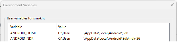

Android Software Development Kit (SDK)
After installing and setting up Android Studio, the SDK path has to be added to the System Environment Variables under the User Variables. After saving make sure to restart the system to apply the changes correctly.
  • Variable Name: ANDROID_HOME
  • Variable Value: %LOCALAPPDATA%\Android\Sdk

  5. After installing and setting up the NDK, the NDK path has to be added to the System Environment Variables under the User Variables. After saving make sure to restart the system to apply the changes correctly.
  • Variable Name: ANDROID_NDK
  • Variable Value: %LOCALAPPDATA%\Android\Sdk\ndk-26

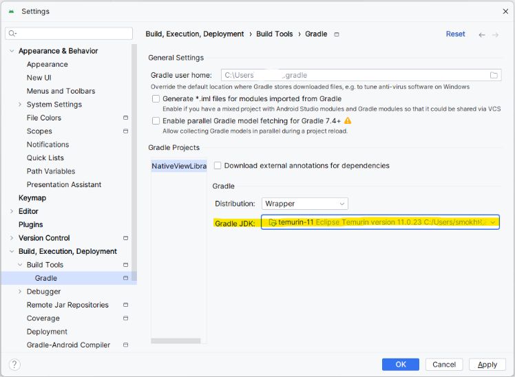

Java Development Kit (JDK)

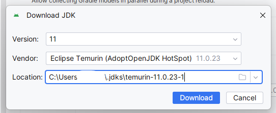

The JDK can be downloaded and used within Android Studio directly. For Android Applications we make use of the Eclipse Temurin 11. When the Android Demo Application has been opened with Android Studio, the Android JDK should be set. On the specific Android Application wiki page the used JDK version is written down.

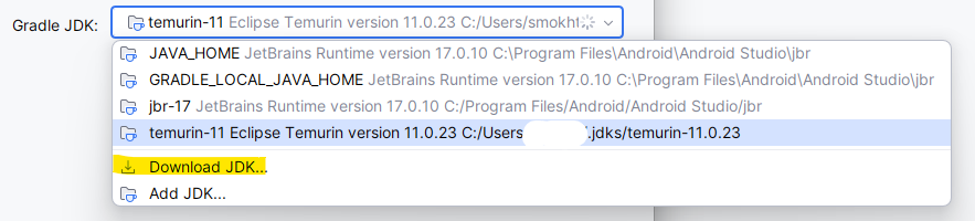

  1. In Android Studio, open [File | Settings | Build, Execution, Deployment | Build Tools | Gradle].
  2. Choose Gradle JDK: Temurin-11 Eclipse Temurin Version 11.
If this version is not available in the dropdown, download it by clicking on “Download JDK…” in the dropdown of Gradle JDK.

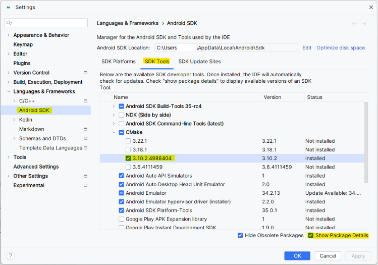

These CMake versions can be installed directly through the Android Studio SDK Manager.
  1. In Android Studio, open [File | Settings | Languages & Frameworks | Android SDK] and navigate to the SDK Tools tab.
  2. Click on Show Package Details on the bottom right of the page.
  3. In the list, make sure only CMake 3.10.2 is selected and installed.
  4. After installing and closing the settings page, make sure to restart the system to apply the changes correctly.
