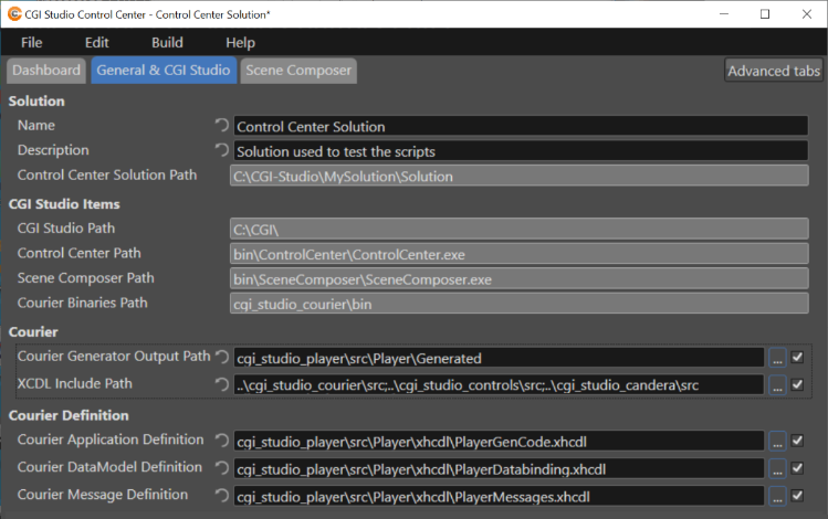

General & CGI Studio
Via the General & CGI Studio tab it is possible to edit solution details and various reference paths. Items that are greyed out cannot be edited. Use the checkboxes on the right to toggle between relative paths and absolute paths. Use a semicolon to list up multiple files.
Solution
  • Name: Name of the solution
  • Description: Description of the solution
  • Control Center Solution Path: The path to the current control center solution
CGI Studio Items
  • CGI Studio Path: The root folder for all CGI Studio components (this folder should contain all CGI Studio libraries like cgi_studio_candera, cgi_studio_courier, bin/SceneComposer, etc).
  • Control Center Path: The path to the Control Center executable
  • Scene Composer Path: The path to the Scene Composer executable
  • Courier Binaries Path: The path to the Courier binaries (CourierEditor.exe and CourierGenerator.exe)
Courier
  • Courier Generator Output Path: The folder in which CourierGenerator should generator all the code
  • XCDL Include Path: The list of paths in which CourierGenerator and CourierEditor will search for the definition files.
Courier Definition
  • Courier Application Definition: The main Courier definition file that will be used by CourierGenerator.
  • Courier DataModel Definition: The path to the file that contains the definition of the data binding items
  • Courier Message Definition: The path to the file that contains the definition of the messages that are used in the application
