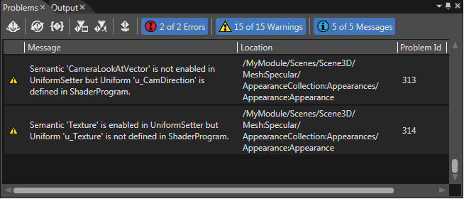

The compilation result can be seen in the "Problems Browser" panel. For further information please refer to section Problems Browser.
After successful shader compilation, a regarding message is displayed.

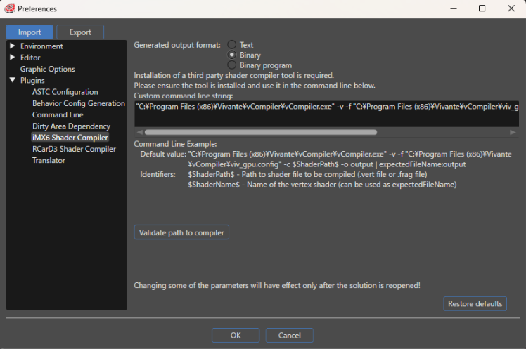

iMX6ShaderCompiler provides support for exporting compiled (and/or linked) shaders to the asset file.
It can be configured from File/Preferences section and provides some parameters which can be changed in order to achieve the desired behavior:
1. Output type:
  • a. Binary - exports compiled shaders (separate compiled vertex and fragment shaders)
  • b. Binary program - exports a linked shader pair (in the asset file, the vertex shader will contain the compiled and linked pair and the fragment shader will contain an empty buffer)
  • c. Text - exports the source code of the shaders (separate source code for vertex and fragment shaders)
2. Command line - a configurable string of the following format:
<path_to_executable_file> [arg0] [arg1] [arg2] ... [argN] | expectedFileName:<output_file_name>
  • a. The path to executable to be run in order to generate the compiled/linked shaders along. The executable itself can be specified alone (no path) if the path to it's parent directory is found in the system environment path. Paths which cointain spaces need to be delimited by double quotes. Example: "C:\My Projects\Vivante\vCompiler.exe"
    If vCompiler.exe is not available, in order to avoid an error related to the executable file missing, for host assets the output format for the generated shaders can be set to text. For more information related to vCompiler please check vCompiler
  • b. The arguments (parameters to be passed to execution). Some special parameters which identify the current processed shader can be specified (they are detailed below). Examples: $ShaderPath$, $VsPath$
  • c. The expected file name specifier: specifies the name (without extension) of the output file and is separated from the rest of the command (a and b) by a pipe '|'. iMX6 shader compiler expects output files with the following extensions: i.) .vgcSL - compiled vertex shader (applies for Binary output only) ii.) .pgcSL - compiled fragment shader (applies for Binary output only) iii.) .gcPGM - compiled and linked shader pair (applies for Binary program output only)
Example: For binary output, "expectedFileName:output" - requires that a compiled vertex shader file will be named output.vgcSL and a compiled fragment shader file will be named output.pgcSL
The command line for "Binary" output is a little bit different than the one for "Binary program" output.
Binary output command line: this command line is invoked separately for each vertex and fragments shader.
Example: "C:\Vivante\vCompiler.exe" -s4 -c $ShaderPath$ -o output | expectedFileName:output
