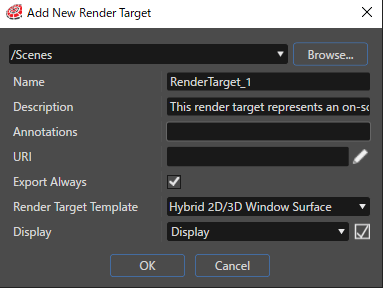

A new render target can be added using one of the following possibilities:
Go to "Platform" > "New Render Target" in the menu bar or go to the Render Targets panel, right click on a node under the display and select "New Render Target" from the context menu.
Set the following items in the Add New Render Target dialog box and click [ OK ] to create a new Render Target.
Item Description
Top input field The location where the Render Target is saved in Solution Explorer
Name The Render Target Name
Description The Render Target Description
Annotations The Render Target Annotations
URI The Render Target URI
Export Always If enabled, the Render Target selected at the time of asset generation is always exported to the asset.
Render Target Template The Render Target template
Display The display that is linked to the Render Target
The types available depend on the SceneComposer platform of a given solution, respectively of the feature set of the Candera Device specified by the platform.
