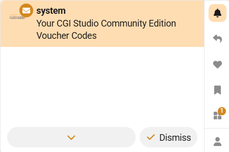

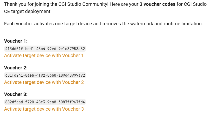

  • Sign up to the Candera Community Forum. You will receive a system notification granting access to three license vouchers.
  • Open the notification. It will contain the following message:

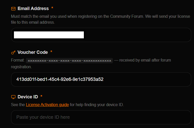

  • For a voucher, select the corresponding activation link (e.g., “Activate target device with Voucher 1”).
    You will be redirected to the activation page.
  • After submitting the Device ID and completing the voucher activation process, you will receive an email containing your hardware license file (.lic).
