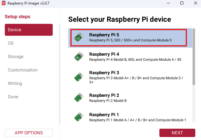

- Open Raspberry Pi Imager and in the Device section select Raspberry Pi 4 or Raspberry Pi 5, depending on your model. Afterwards click "Next".

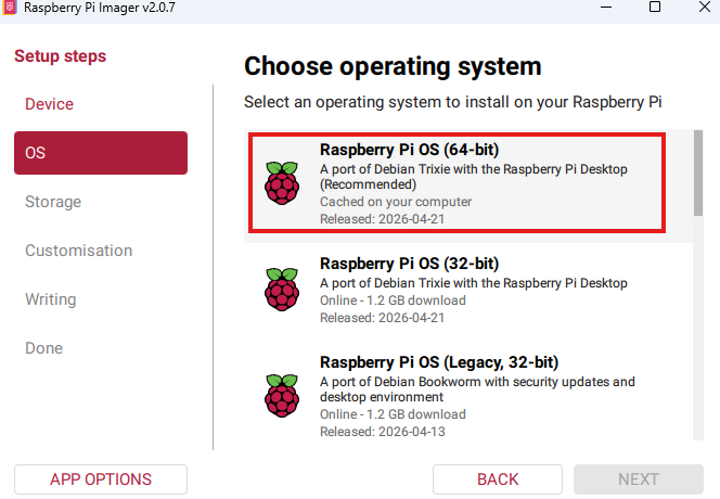

- In the menu Choose operating system select "Raspberry Pi OS (64-bit)". Then click "Next".
Make sure to select the 64-bit version, since lower versions are not supported!

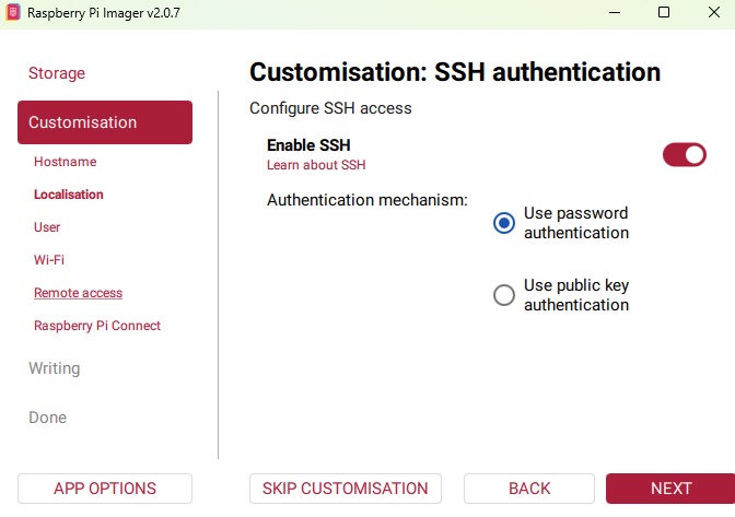

- In the Customisation step click "Next" till the "Customisation: SSH authentication" configuration occurs. Make sure that SSH is enabled.
- Click "Next" and write the image to the SD card. This may take some time.

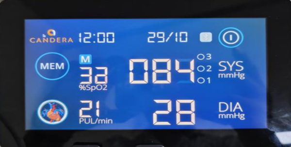

Run Blood Pressure Sample with Target Player
The Blood Pressure Device sample is a Scene Composer sample that demonstrates a blood pressure measurement device with exemplary scenes and animations. General information on this sample can be found in the Blood Pressure Solution documentation.
Execute the following command on the Raspberry Pi device to run the sample using our target player.
/opt/candera/bin/Player /opt/candera/Python/Samples/BloodPressureDevice/BloodPressureDevice.bin
The asset will be visible on the target device.

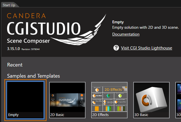

- Start Scene Composer in <cgi-studio-installation-path>\bin\SceneComposer\Scenecomposer.exe
- Open Empty Solution by either double clicking the empty solution thumbnail or through the File > New Solution dialog.

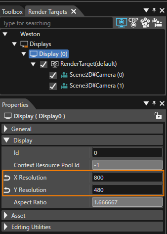

- In the Render Targets panel (on the right side of the SceneComposer), set the resolution of Display (0) to X Resolution (width) of 800 and Y Resolution (height) of 480.

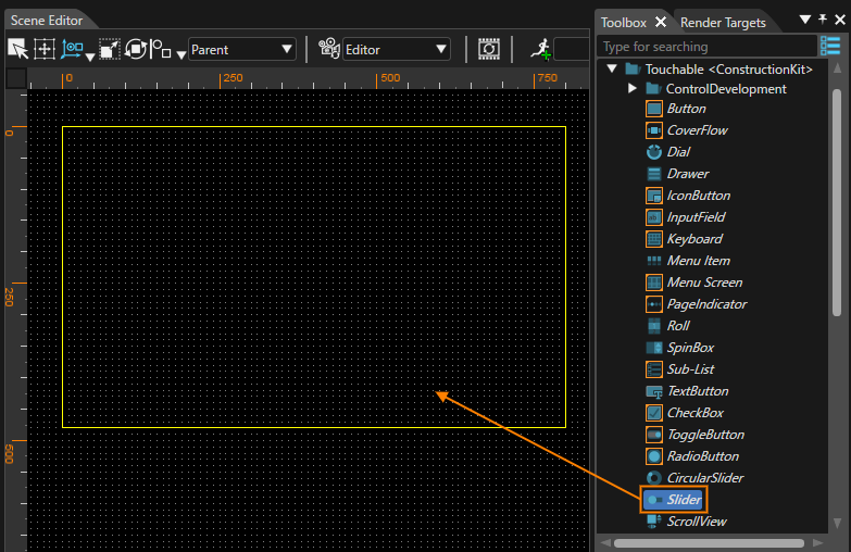

- Drag and drop a Slider Control and a Gauge Control from the Control section of the Toolbox (on the right side of the Scene Composer) into the Scene Editor.

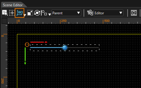

- You can move the controls in the Scene Editor by selecting the translation icon (the red square in the screenshot below) in the top left corner of the Scene Editor and then selecting the control which you want to move. Just select the item you want to move and drag it to a new location.

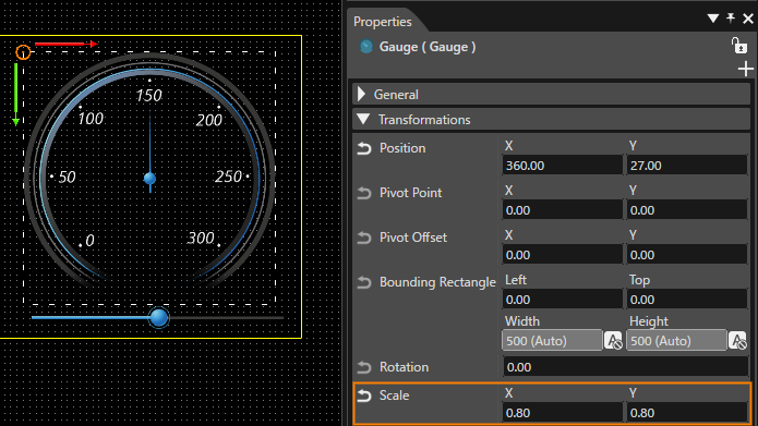

- Select the Gauge Control in either the Scene Editor or the Scene Tree, navigate to the properties, and adjust the scale to ensure it fits comfortably within the display.

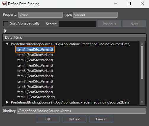

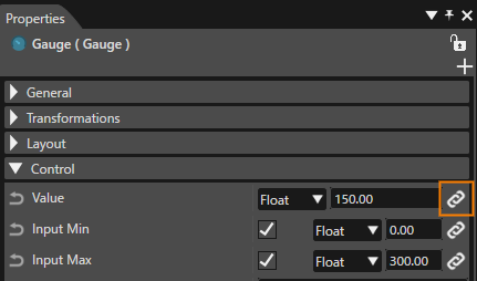

- To set up a data binding for the Gauge value, first select the Gauge either in the Scene Editor or the Scene Tree. In the properties panel locate the Value property under the Control section and click the chain icon next to it to establish the binding.
A "Define Data Binding" window will appear. In this window, select Item1 (under PredefinedBindingSource1). Finally, click OK at the bottom to confirm your selection.
- To set a data binding for the Slider property, select the Slider control in either the Scene Editor or the Scene Tree. Then, click the chain icon next to the Value property in the Control section of the Properties panel. Next, choose Item2 (under PredefinedBindingSource1) from the available options.

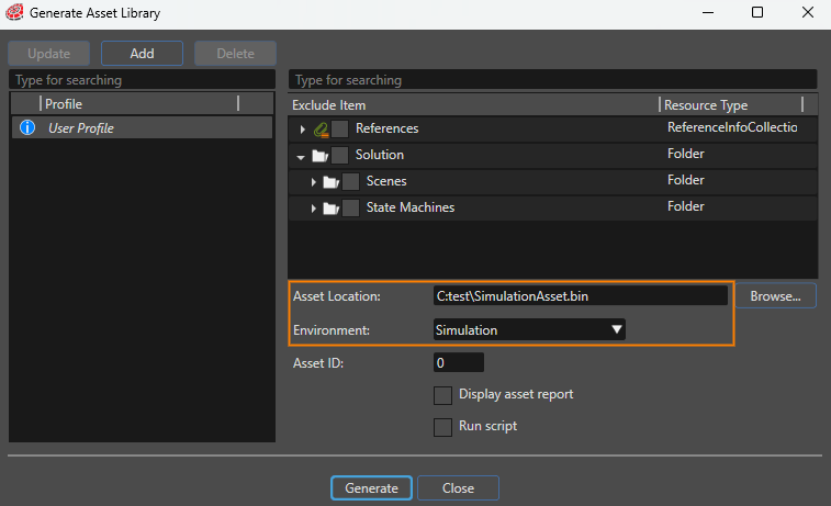

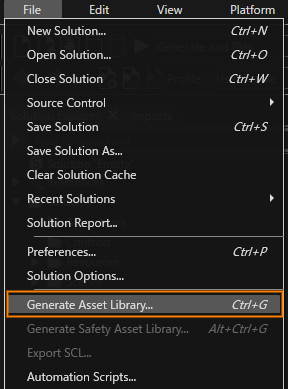

- Next, generate an asset library for the target environment to run the solution in the player.
