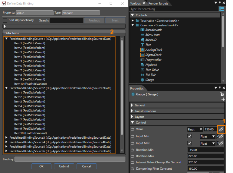

To select and use the predefined set of data bindings follow the steps in the image below
  1. Click on the chain icon near a bindable property in the properties panel.
  2. Select a predefined binding item from the list in the modal window that follows the nomenclature described above.
